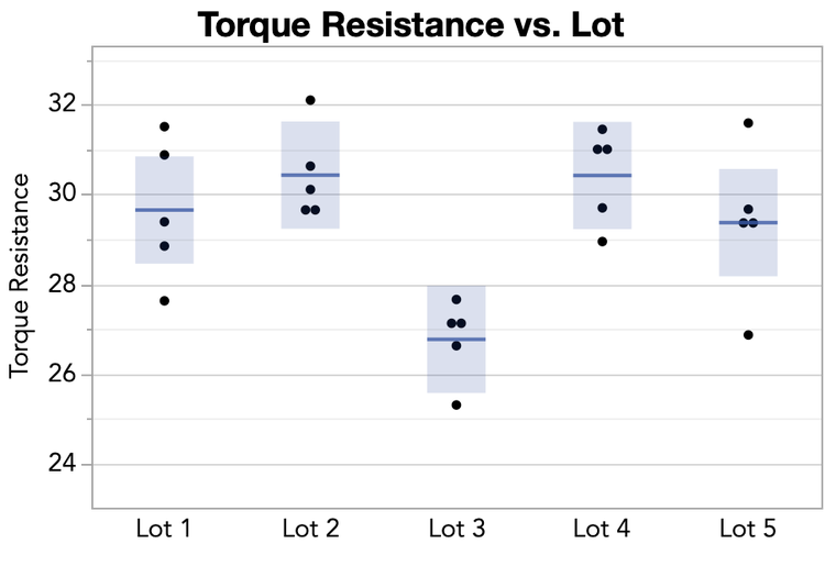

You measure viscosity using an instrument that rotates a spindle immersed in the jar of adhesive. This test yields a measurement called torque resistance. You test five jars selected randomly from each of the most recent five lots. You obtain the torque resistance measurement for each jar and plot the data.
Figure 1: Plot of torque measurements by lot
From the plot of the data, you observe that torque measurements from the Lot 3 jars tend to be lower than the torque measurements from the samples taken from the other lots. When you calculate the means from all your measurements, you see that the mean torque for Lot 3 is 26.77—much lower than the other four lots, each with a mean of around 30.

Based on these results, you decide to hold Lot 3 for further testing. In your report you might write: The torque from five jars of product were measured from each of the five most recent production lots. An ANOVA analysis found that the observations support a difference in mean torque between lots (p = 0.0012). A plot of the data shows that Lot 3 had a lower mean (26.77) torque as compared to the other four lots. We will hold Lot 3 for further evaluation.
Remember, an ANOVA test will not tell you which mean or means differs from the others, and (unlike our example) this isn't always obvious from a plot of the data. One way to answer questions about specific types of differences is to use a multiple comparison test. For example, to compare group means to the overall mean, you can use analysis of means (ANOM). To compare individual pairs of means, you can use the Tukey-Kramer multiple comparison test.
