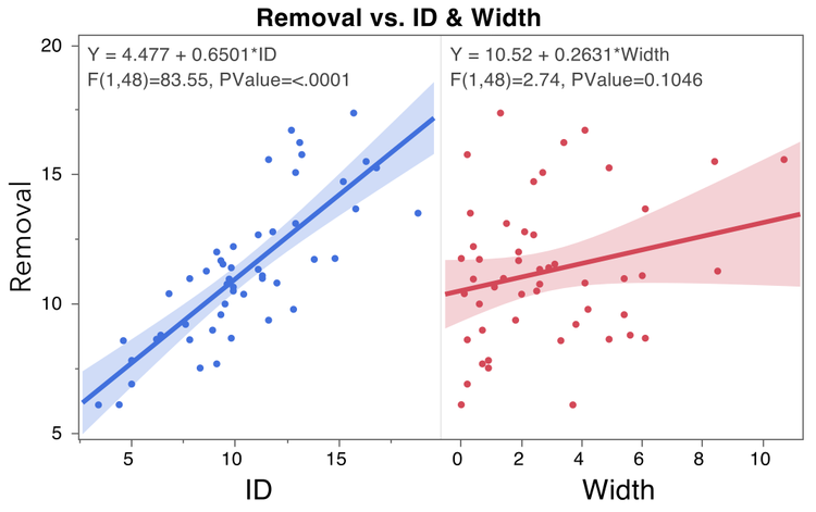

Continuing with this example, we learn that there is a significant relationship between Removal and ID, and that for a 1-unit increase in ID, Removal increases by 0.65 units on average. We also learn that there is not a significant relationship between Removal and Width. In other words, there is no association between changes in Width and changes in Removal.
However, fitting simple linear regression models for each predictor ignores the information in the other variables.

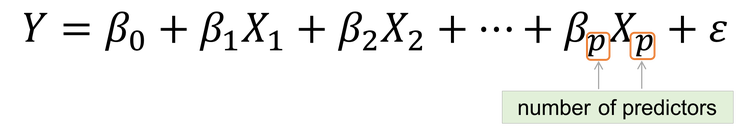

When we fit a multiple linear regression model, we add a slope coefficient for each predictor. For the Cleaning example, with OD and ID as predictors, the model has slope coefficients for both predictors.
Each coefficient represents the average increase in Removal for every one-unit increase in that predictor, holding the other predictor constant. What if we have more than two predictors? As a generalization, let’s say that we have p predictors. The multiple linear regression model can be extended to include all p predictors.
