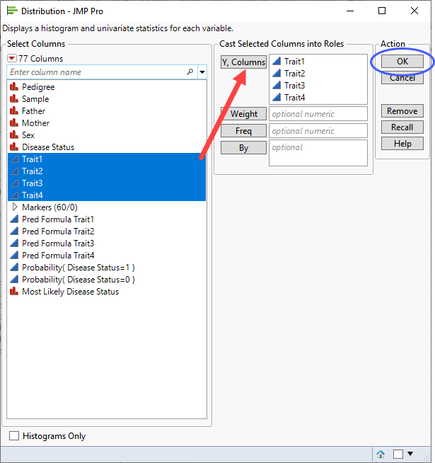

8 | Open the Genotypes Pedigree.jmp data set. |
8 | Click Analyze > Distribution. |
8 | Select the 4 Trait columns as the Y, Columns. |
8 | Click . |

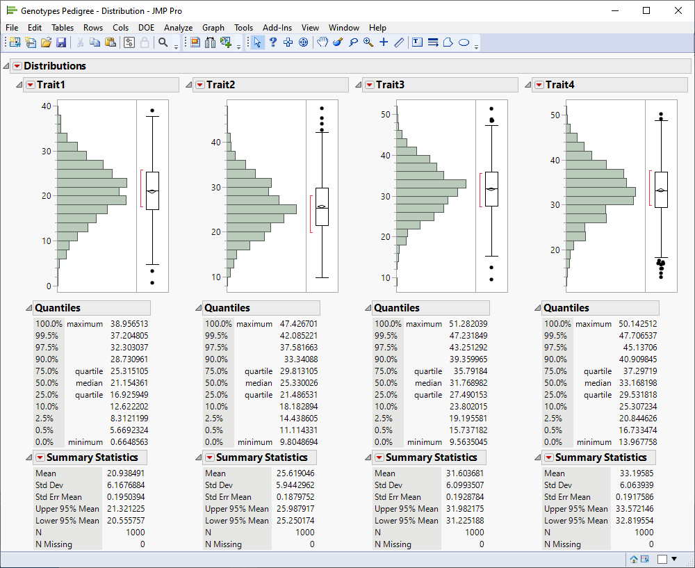

The following report is generated:
A histogram and box plot is generated for each column showing the distribution of the values for the respective traits. In addition, summary statistics are generated for each column. The plots and statistics enable you to get an overall feel for the data and can provide an indication of the overall quality of the data.

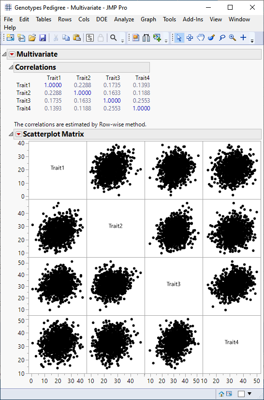

Summary statistics and a scatter plot show no significant correlation between traits, suggesting they occur independently of each other

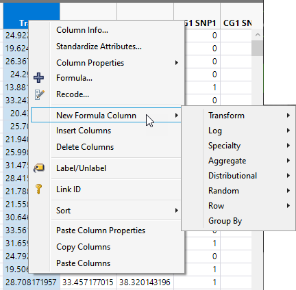

You can transform the data in one or more columns using the New Formula Column option accessible by right-clicking in the header of one or more selected columns. The transformed data is contained in new columns added to the right of the selected columns.
The most useful transformations include options under the Transform and Log menus.

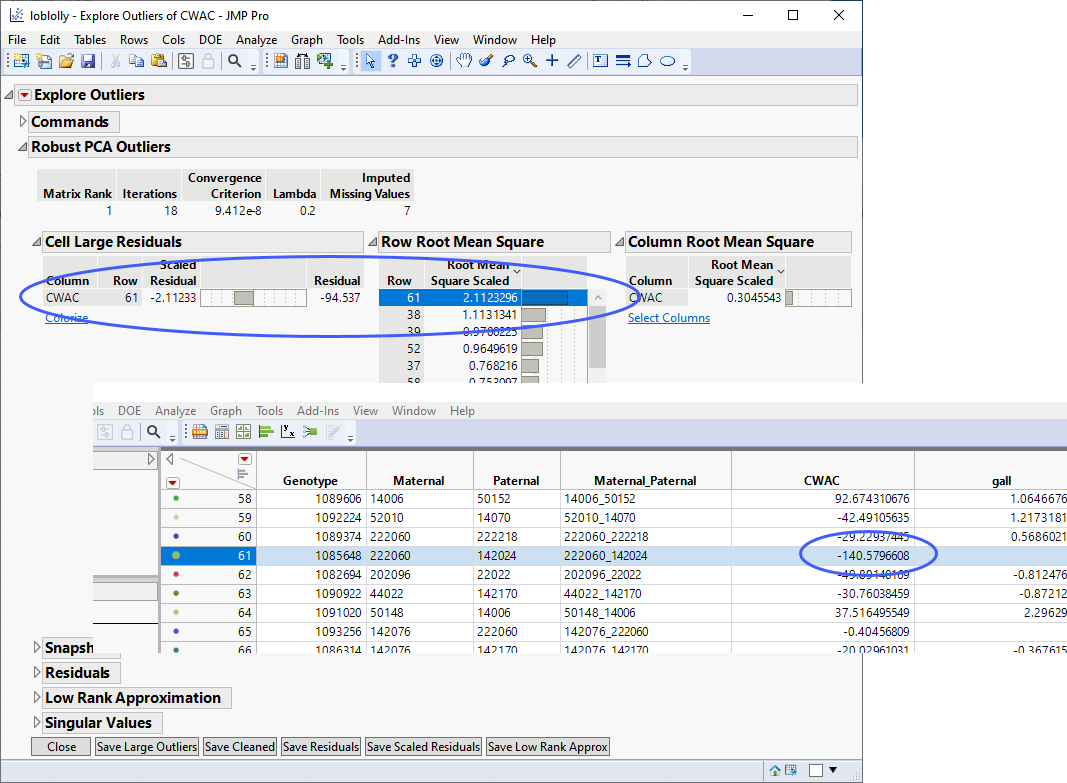

Outliers in data can be due to mistakes in data collection or reporting, measurement systems failure, the inclusion of error or missing value codes in the data set, or simply an unusual value. The presence of outliers can distort estimates and bias results toward those outliers. The Explore Outliers platform enables you to identify, explore, and manage outliers.
Analysis of crown width among a cohort of loblolly pine trees, revealed one outlier (line 1085648, row 61).
The effect of this outlier was observed in a volcano plot generated during a Genome-Wide Association Study (GWAS) of this data (see Genome-Wide Association (GWAS)).

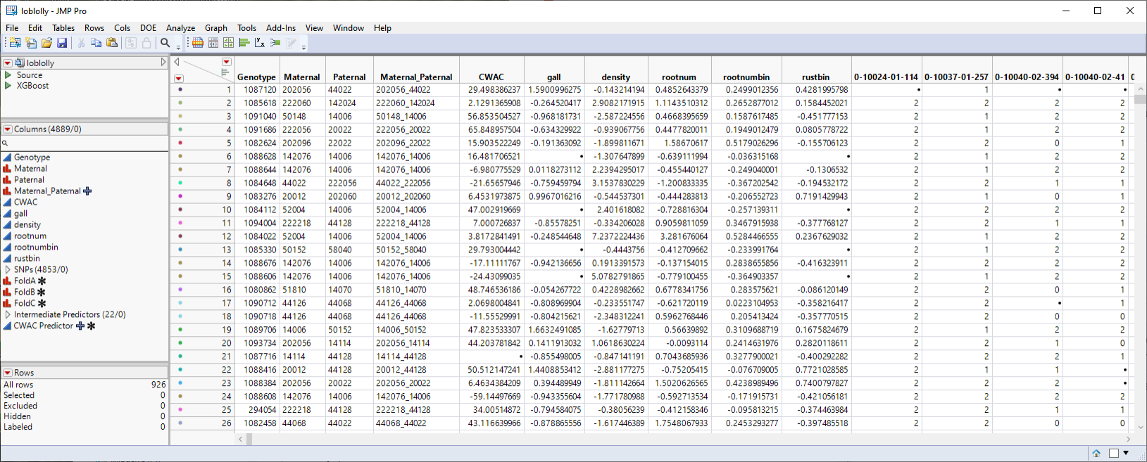

The data used as an example in this chapter is from a study of the accuracy of different genomic selection methods in Loblolly pine by Resende, et al. 20121 and was downloaded from GEO, opened in JMP, and saved as the loblolly.jmp table shown below. A zip file containing this JMP table is available here for you to download.
Examination of this table reveals a significant amount of missing data. We can use the Explore Missing Values platform to impute the missing values.
