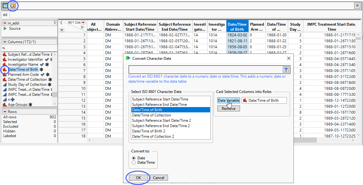

The following JMP table was generated when the Demographics Distribution report was run for the Nicardipine example study.
The Date/Time of Birth column (highlighted above) will be converted. Note the icon (circled, above), next to the highlighted column in the Columns pane, indicating this variable is a character (nominal) variable.
To Convert a Character Date
8 | Make sure your JMP table is open and in focus. |
8 | Click ![]() |
8 | Highlight the column to be converted. |
8 | Click | to specify the highlighted column.
8 | Click . |

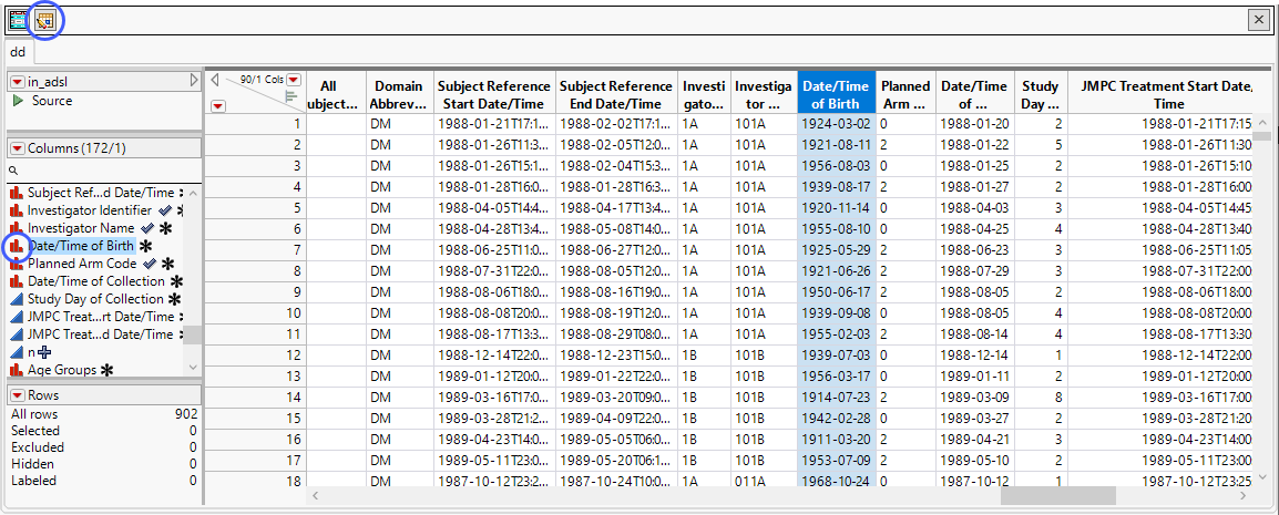

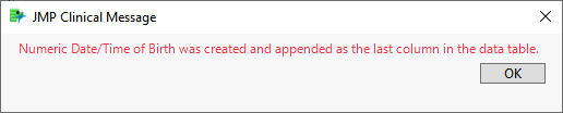

This report adds a new column (highlighted below) containing the converted date values to the end of the JMP table.
Note: The label for the new column has “Numeric” appended to the original column label.

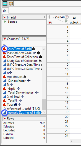

Compare the icon (circled, above) for the original column in the Columns pane with the
(circled above) for the new column. indicating the new variable is a numeric (continuous) variable.
