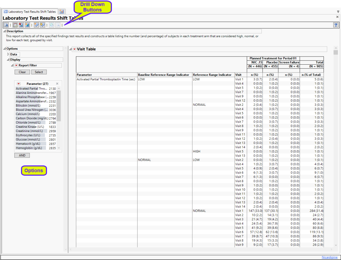

Running Findings Mean Change from Baseline Tables for Nicardipine using default settings generates the report shown below.
It contains the following elements:
Table
• The table lists the number (and percentage) of patients within each treatment arm whose values for each findings test fall into specific high, normal and low ranges for those tests.
