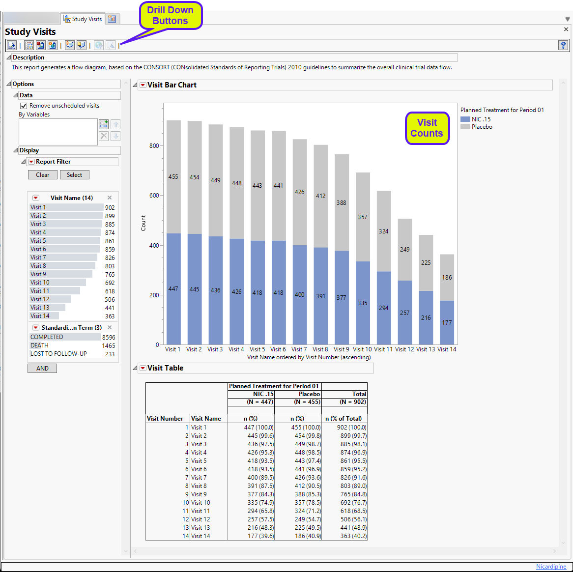

The Study Visits report generates graphical and tabulation displays of study visit attendance. Additionally, a distribution of study days for each specified visit is shown.
Report Results Description
Running this report with the Nicardipine sample setting and default options generates the output shown below.
The Report initially displays Subject Visits Details in a stacked Bar Chart colored by treatment and a table summarizing the number (and percentage) of subjects in each treatment ARM that attended each visit.

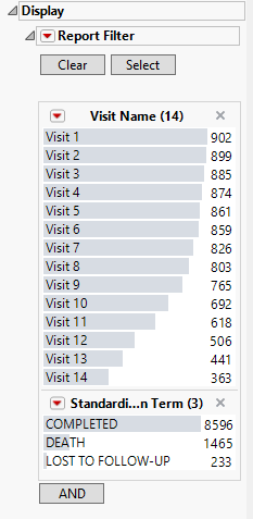

Report Subject Filters
These filters enable you to subset and view subjects based on demographic characteristics and other criteria. Refer to Data Filter for more information.
