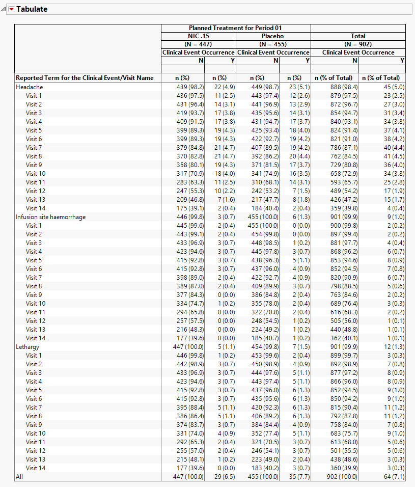

Running this report using a modified Nicardipine study and default settings generates the Report shown below.
Table
The report contains one table:
The table lists clinical events and reports their occurrence (both as counts and percentages) across individual procedures and treatment arms as well as providing total occurrences. The counts, represented by n, are the number of subjects who experienced the given clinicalevent. The first column lists the clinical event as well as the visit name, if available. Each treatment arm is split into columns for whether the clinical event occurred or not.
