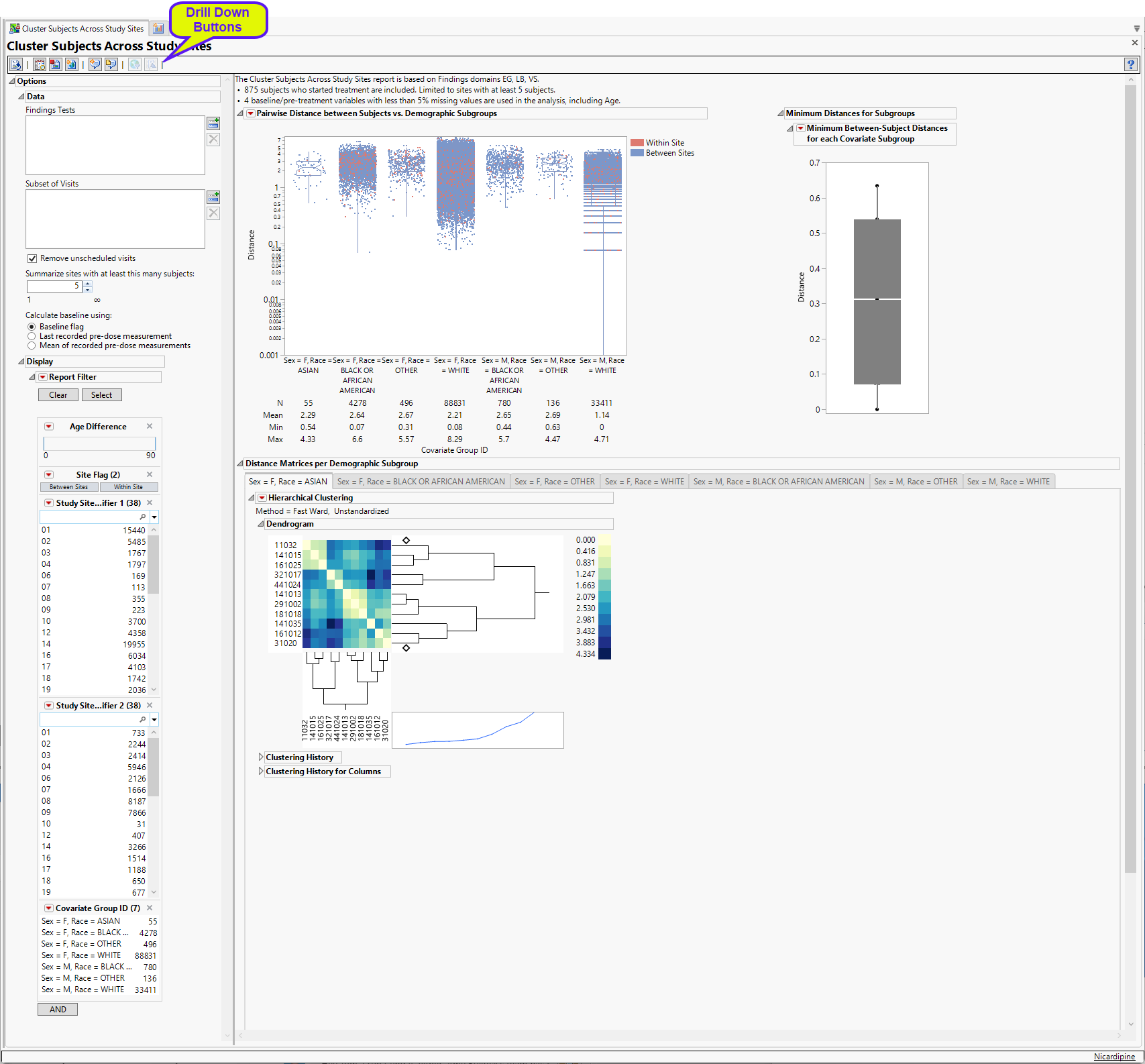

Running this report using the Nicardipine sample setting and default options generates the output shown below. This report uses pre-dosing information with the goal of identifying subjects that have enrolled at two or more clinical sites.
The Cluster Subjects Across Study Sites report shows the results of clustering of the subjects on the basis of different combinations of covariates (demographic subgroups in this example). The results for each grouping are presented on a separate “section”. This report initially shows two sections Between-Subject Distance Summary and Subgroup Clustering. Use the available options in each section to drill-down into the data.

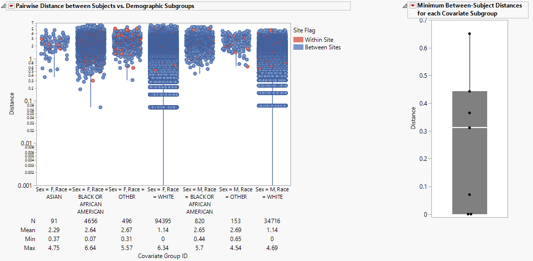

Box plots are presented for all pairwise distances between subjects in the selected population. Individual points are overlaid with the box plot, with the colors differentiating 'Between Sites' and 'Within Site' distances. The Y-axis is set to log-scale by default for the ease of identifying small distance points when the range of distance is large. A summary table is shown below the boxplot presenting the N, Mean, Min, Max values for each covariate group.
In this example, box plots are presented by gender and race. The more similar a pair of subjects, the smaller the distance value (a zero indicates a perfect match). Note that when using the log-scale, the zero values are not presented in the graph (e.g. Sex=F, Race=WHITE and Sex=M, Race=WHITE), but can be observed in the statistics summary table.
One Box Plot of Minimum Between-Subject Distances for Each Site. The minimum distance from each covariate subgroup is presented in the box plot to the right.
The subgroup with the most similar pair of subjects is presented in the Subgroup Clustering section.

One or more Subgroup Clustering sections: The Hierarchical clustering results for each demographic subgroup are presented in different panels. The name of a panelis dependent on the covariate values used.
The Sex = F, Race =ASIAN subgroup clustering section is shown below:
A heatmap with subject IDs being rows and columns annotations. The legend shows the pairwise distance values with a minimum of zero. All the pairwise distance matrices, along with the subjects' ID , study sites and treatment arms, are stored in separate jmp tables, and can be accessed by clicking the 'View Tables' button.

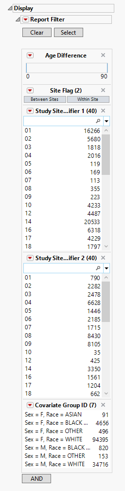

Report Filter
These filters enable you to subset and view subjects based on demographic characteristics (Age Difference, Site Flag), study sites (Site IDs for the two subjects in the pairwise comparison), and other criteria (covariate ID). Refer to Data Filter for more information.
Refer to the Data Filter documentation for more information
