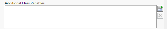

To Specify Additional Class Variables:

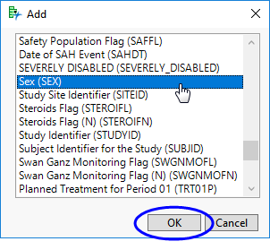

8 | Click to open the Add window (shown below) that lists each variable contained in ADSL or the domain and SUPPxx (if merged) specific to this report. |
8 | Select the variables you want to include in the analysis and click to add those variables to the text box. |

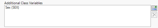

In this example, SEX was selected and added.
