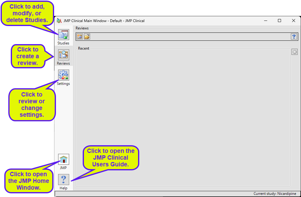

JMP Clinical Main Window
When you open JMP Clinical, the first window you see is the JMP Clinical Main window:
There are five buttons aligned on the left side of the JMP Clinical Main Window: Studies (), Reviews (), Settings(), JMP ()and Help(). The Reviews tab is selected by default.
