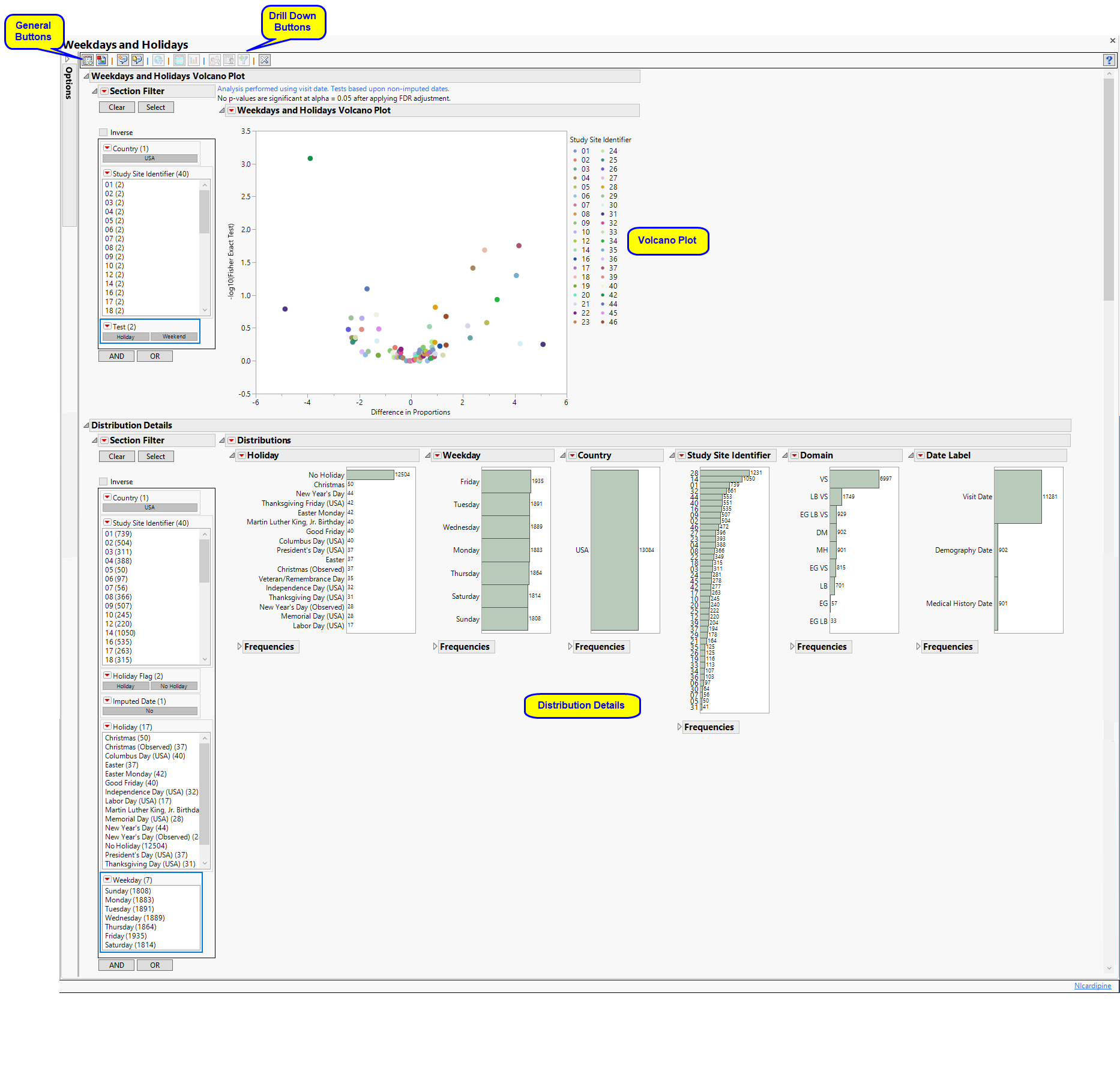

The Weekdays and Holidays report initially shows a Weekdays and Holidays Volcano Plot and the Distribution Details.

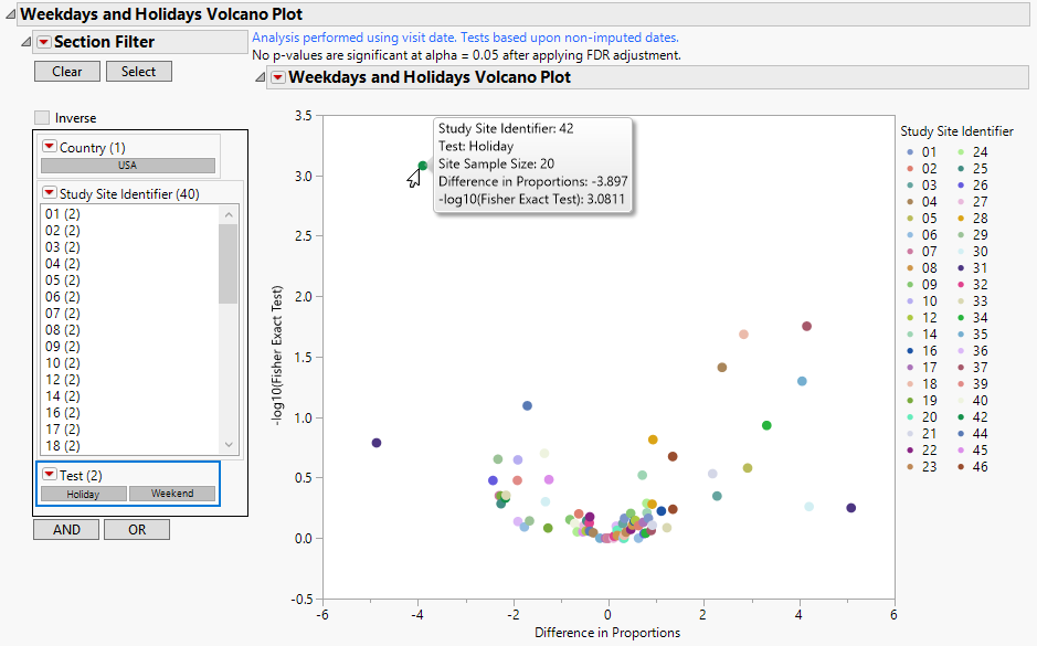

Compares the difference in proportions of visits on specific weekdays and holidays for each study site with the combined averages of all of the other study sites.
Note: In those instances where a study is conducted at one site only, no volcano plot is generated.
It contains the following elements:
One Data Filter.
Enables you to subset subjects based on country of origin and study site. Refer to Data Filter for more information.
One Volcano Plot.
The volcano plot is used to determine the deviation of the proportion of study visits at each study site that occur on specific weekdays and holidays with the overall proportions for the whole study. Those sites plotting close to 0 on both axes show little or no difference from the averages across all study sites. Those sites plotting more distally (such as site 42 in the figure above, for example) show deviation from the averages.
See Volcano Plot for more information.

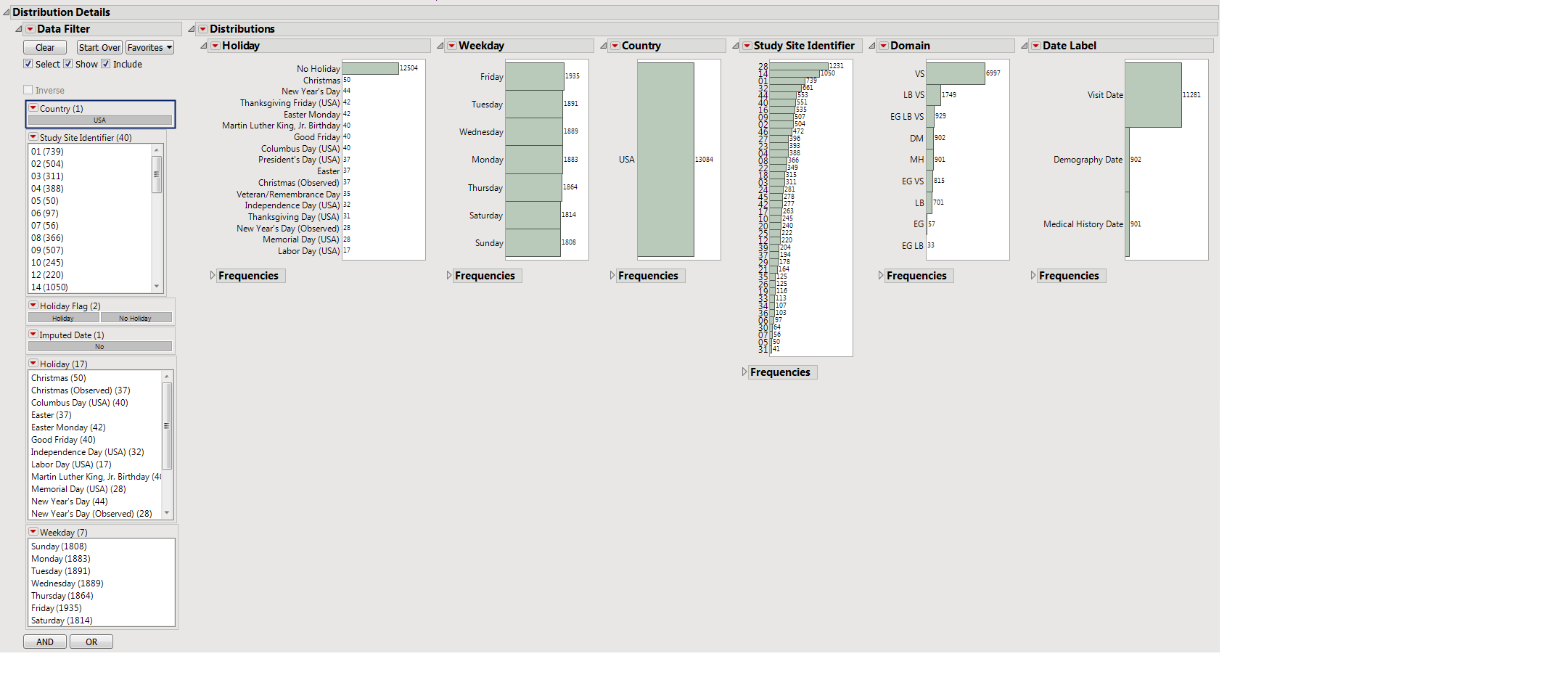

Summarizes several Histograms describing characteristics of visit dates, demography dates, and medical history dates.
One or more Histograms.
Histograms detail the levels and frequencies of Holidays, Day of Week (Weekday), Country of Study Site, Study Site identifier, and Date Label (whether the date refers to a Visit Date or the date Medical History or Demography information are collected).
See Distribution for more information.
One Data Filter.
Enables you to subset subjects based on country of origin, study site, and holidays and weekdays.. Refer to Data Filter for more information.

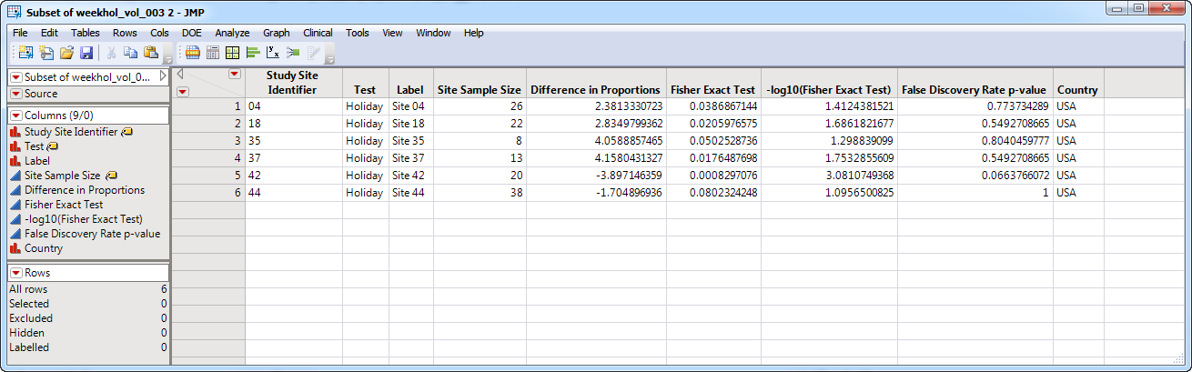

Show Sites: Shows the rows of the data table for selected points (in this example, the points shown in the figure above) from the volcano plot.
Clicking opens the following table:

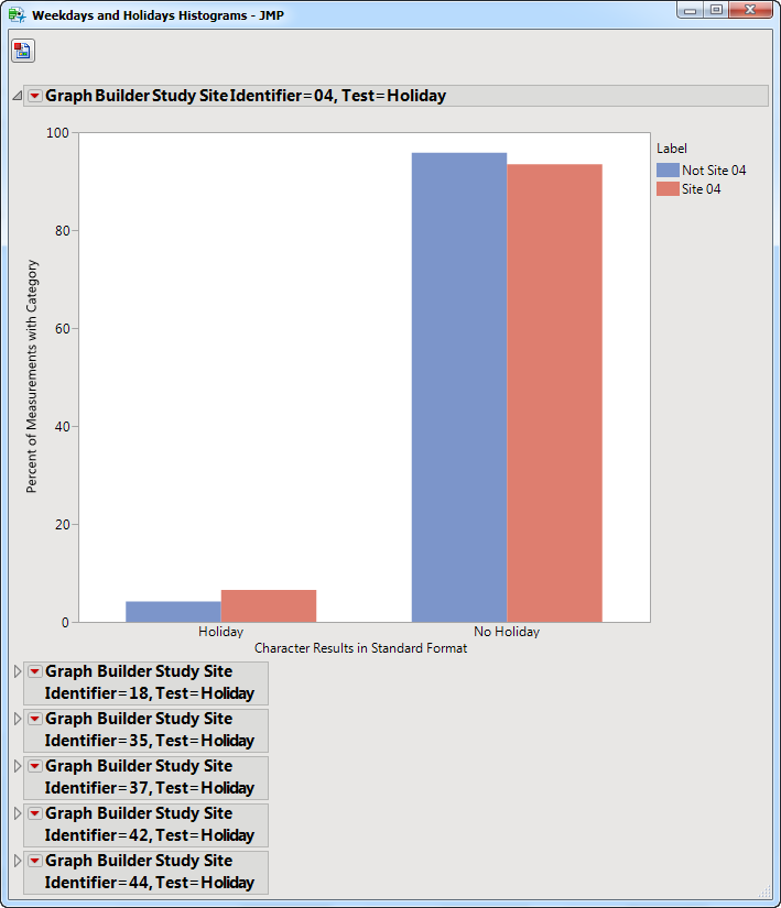

Visit Bar Charts: For the points selected in the volcano plot, clicking displays a bar chart comparing the percent of subjects with visits occurring on specific weekdays and holidays between selected sites versus all others. This gives the user the ability to compare just how different each site is. The following chart shows the sites/tests selected above:

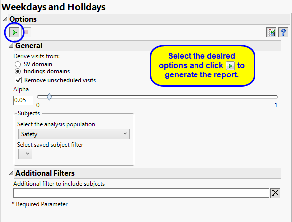

General
Visits
This report helps you determine whether visit dates fall on either weekends and/or holidays, which might be unusual and call for closer examinations of the data. You can Derive visits from: either from the SV domain or from the findings domains.
Unscheduled visits can occur for a variety of reasons and can complicate analyses. By default, these are excluded from this analysis. However, by unchecking the Remove unscheduled visits box, you have the option of including them.
Alpha
The Alpha option is used to specify the significance level by which to judge the significance of the deviation of the proportion of study visits at each study site that occur on specific weekdays and holidays with the overall proportions for the whole study. Alpha can be set to any number between 0 and 1, but is most typically set at 0.001, 0.01, 0.05, or 0.10. The higher the alpha, the higher the error rate but also higher the power for detecting significant differences. You will need to decide on the best trade-off for your experiment.
Filtering the Data:
Filters enable you to restrict the analysis to a specific subset of subjects, based on values within variables. You can also filter based on population flags (Safety is selected by default) within the study data.
See Select the analysis population, Select saved subject filter1, and Additional Filter to Include Subjects, for more information.
