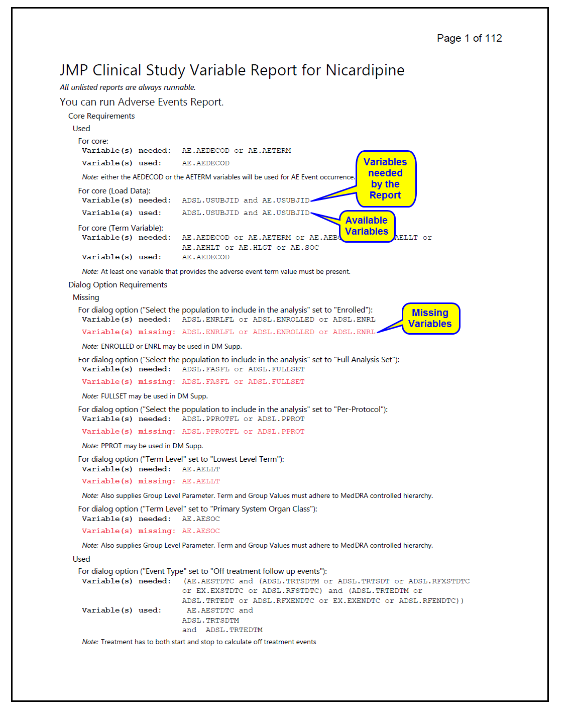

Report Results Description
Running this report for Nicardipine using default settings generates the PDF report shown below. Only the first page is shown.
Note how needed, available, and missing variables are indicated.

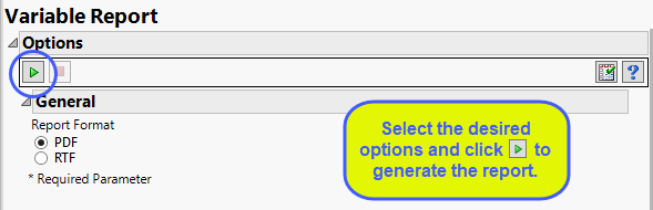

General
You can use the output options to specify the format (PDF or RTF)of the final report.
