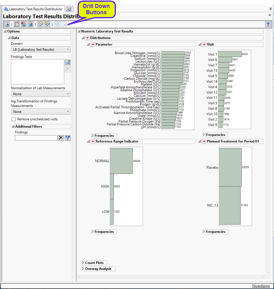

Running Findings Distribution for Nicardipine using default settings generates the Report shown below.
The Report contains the following sections:
Numeric Results
Displays distributions, count plots and statistics for numeric findings results.

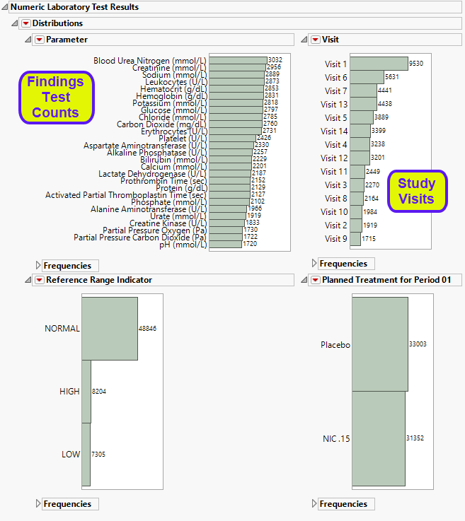

Distributions
Contains Histograms to display the distribution of numeric Findings tests taken during the study and other relevant variables for the selected Findings domain.
• | One Findings Test Counts Graph. |
This graph shows a Histogram displaying the number of measurements taken for each findings test (xxTESTCD) during the study.
• | A set of Distributions. |
These display counts and histograms of relevant variables in the Findings data set. A distribution of subjects on the Actual, Planned, or Specified Treatment is shown as well as other findings variables (if present). Findings variables displayed can include the Reference Range Indicator1 (xxNRIND), the Visit and Time Points at which findings were taken (VISIT and xxTPT), and Baseline Flag (xxBLFL.
These distributions are useful for understanding the frequency and details of findings tests taken during a study. All distributions are linked: You can select bars in one histogram to see where those measurements fall in other findings variables shown on the display. Once you make selections, you can use the down buttons to down on those selected subjects.

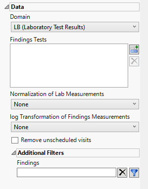

Data
Domain
Use this widget to specify whether to plot the distribution of measurements from either the Electrocardiogram (EG), Laboratory (LB), or Vital Signs (VS) findings domains.
Findings Tests
Use this widget to select specific Findings tests.
8 | Click to open the Add window (shown below) that lists available test names (shown below). |
8 | Select the desired test(s) and click to add them to the text box. |
Normalization of Lab Measurements
Use this widget to select a normalization to be applied to the baseline and on-therapy measurements. Refer to Normalization of Lab Measurements for more information.
log Transformation of Findings Measurements
Use the drop-down menu to select the log transformation to be applied to the baseline and experimental measurements. Refer to log Transformation of Findings Measurements for more information.
Remove unscheduled visits
You might or might not want to include unscheduled visits when you are analyzing findings by visit. Check the Remove unscheduled visits to exclude unscheduled visits.
Additional Filters - Findings
This filter lets you restrict your analysis to only those subjects that meet specific criteria at the level of the specified Findings domain (EG, LB, or VS) . See Findings for more information.
