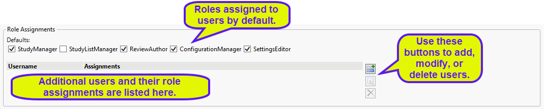

One of the key components of the system.clinical.preferences file is the specification of user role assignments. A user role defines the level of functional interactivity that a user has in JMP Clinical. The following user roles can be set for individual users.
Study Manager - A user with this role can do all of the operations involved in managing studies within JMP Clinical: add, combine, and refresh metadata, rename or move folders, update a review with a new snapshot, update the study risk data set, and delete studies. The code specification for this role is "StudyManager".
Study List Manager - A user with this role can manage and delete studies from shared folders. By default, this role is not assigned. The code specification for this role is "StudyListManager".
Review Author - A user with this role can create/edit/save Review Templates, do ad hoc analyses, and create and save Reviews. They can also manage the Holiday and Event data set and Risk Threshold data sets used by the configuration. A Review Author implicitly has the Reviewer role as well. The code specification for this role is "ReviewerAuthor".
Reviewer - A user with this role can open Reviews. The code specification for this role is "Reviewer".
Configuration Manager - A user with this role can add and define JMP Clinical configurations. This role is assigned to all users by default. The code specification for this role is "ConfigurationManager".
Settings Editor - A user with this role has access to the Settings tab on the JMP Clinical Main Window. This enables them to select different configurations (if defined), and change how they view Documentation and Help. The code specification for this role is "SettingsEditor".
Important Note: We generally do not recommend restricting the "SettingsEditor" rights from users. This should be done only if you want to severely restrict the use of the system for that user such that they are not able to select configurations.
By default, all users are assigned all roles except Study List Manager. System administrators, however, can restrict individual users to specific user roles using the following procedures. See Adding Users and Specifying Role Assignments for information about specifying user roles.

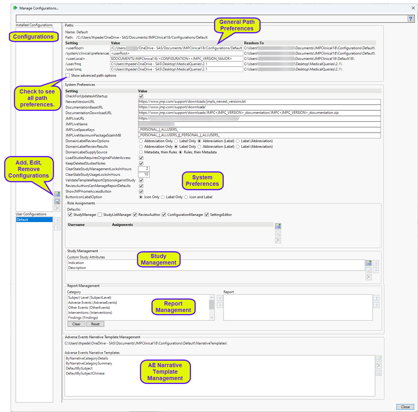

Manage Configurations
The Manage Configurations... Window
The Manage Configurations... window is accessed from the Settings tab of the JMP Clinical Main Window.
8 Click to open the Manage Configurations... window, shown below:

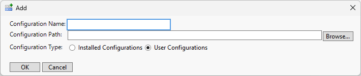

8 Click to open the Add window shown below:
8 Specify a name for your configuration.
In this case, the configuration is named Share.
8 Click to open a Choose Directory window.
8 Navigate into the Clinical Share folder and click .
8 Click the User Configurations radio button.
The Add window appears as shown below:
8 Click .

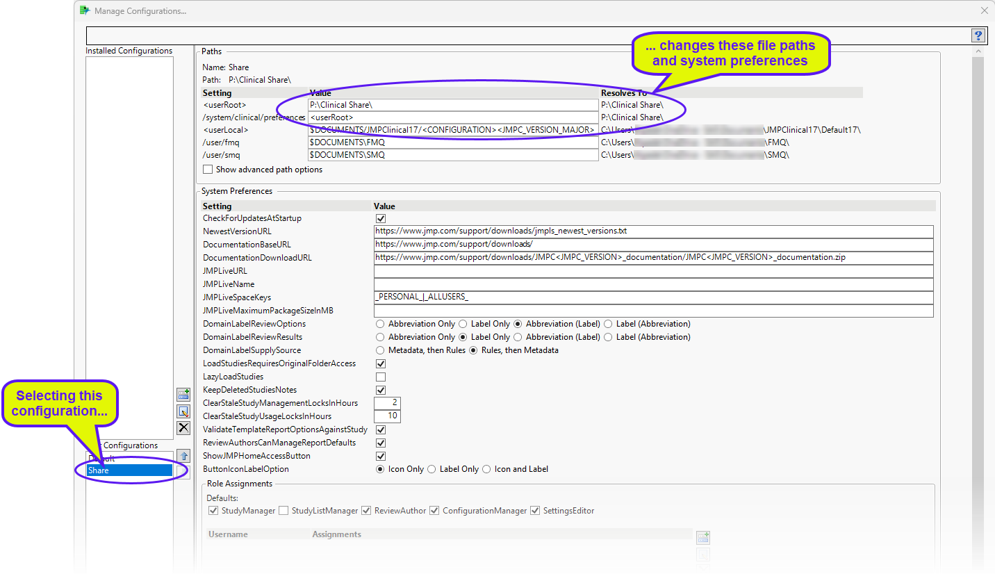

The new configuration is added to the Manage Configurations window. If you select it, all of the default paths and system preferences are displayed, as shown below:
Note: While all paths and preferences are editable, you should consult your system administrator before making any changes.
8 Click to close the Manage Configurations window.
Note: Anyone with Read and Write privileges on the shared drive has access to a new shared folder. As the creator of this folder you can control level of access by changing the permissions using WinOS commands.

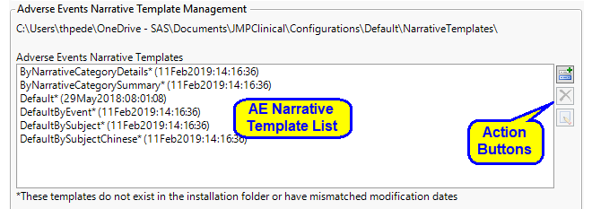

System Preferences for a Configuration
System preferences are specified in the system.clinical.preferences file.
Notes about the system.clinical.preferences File
Note: All preferences are defined in the system.clinical.preferences file. Most users will never need to manually change any of these preferences. You should never open and directly edit the system.clinical.preferences file. Any changes that need to be made can be done in the Manage Configuration... window and should be made only by an experienced System Administrator.
The original syntax for preferences is of the following form:
