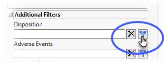

The Where Clause Builder is surfaced from within a report when you click on one of the Additional Filters in the Options pane. Currently, the Where Clause Builder is used in Adverse Events Narrative and Risk Based Monitoring. The Where Filters for Adverse Events (AE) Protocol Deviations (DV), Inclusion/Exclusion Criteria Not Met (IE), Healthcare Encounters (HO), Disposition (DS), Findings (EG, LB, or VS), or Subject (SU) subsets these particular domains to records of particular interest.

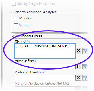

The example below uses the Disposition filter in Risk Based Monitoring. Here, the Disposition WHERE statement is used to select the records (one per subject) that indicate the subjects' completion or discontinuation status.
8 | Click from the Disposition filter |

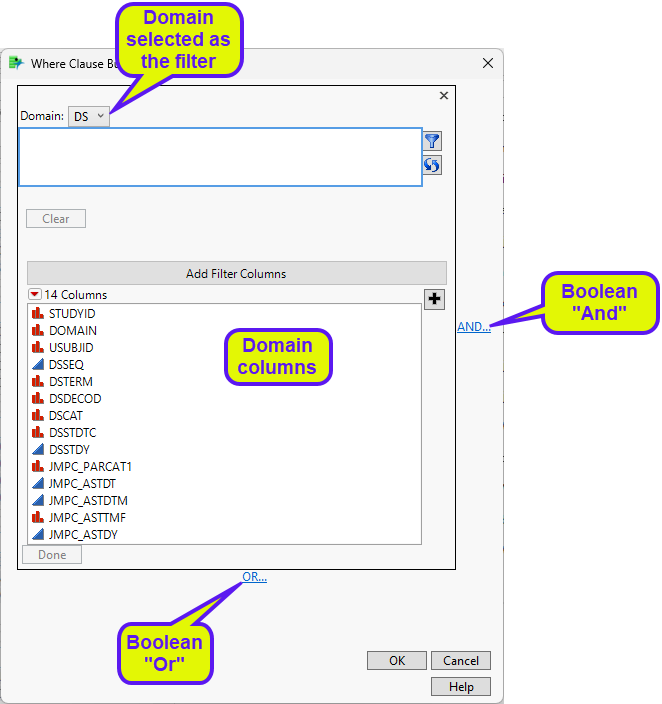

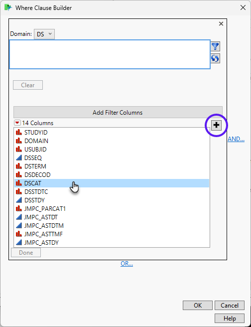

The Where Clause Builder opens.
The DS domain is automatically selected as the domain. All of the columns in the domain are listed and are available for selecting.

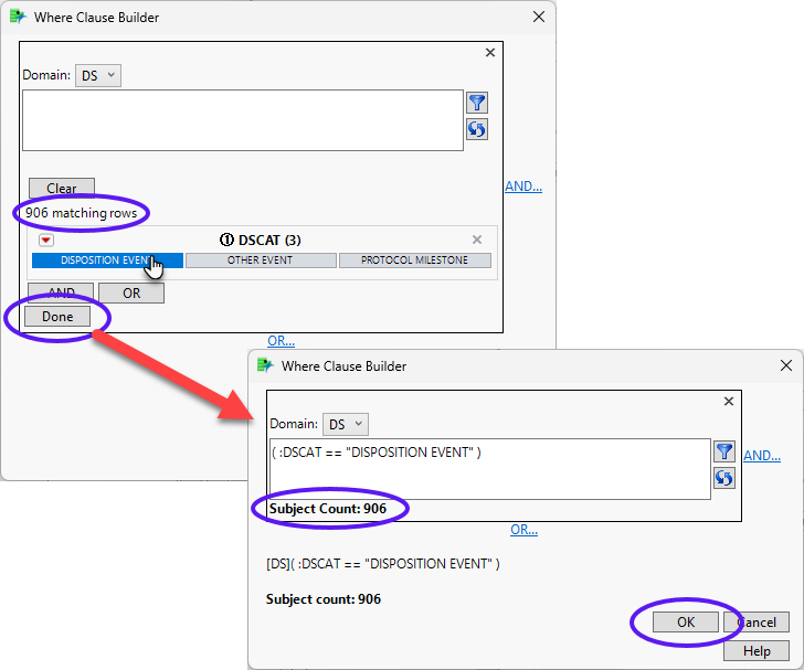

8 | Double-click on a column to select that column. In this example, we select DSCAT and click . |
The column list changes to a list of the different term categories contained in the selected column.
8 | Select DISPOSITION EVENT and click . You can see that we have selected 906 observations which account for the 906 subjects in the Nicardipine study. |
8 | Click to add the filter to the report. |

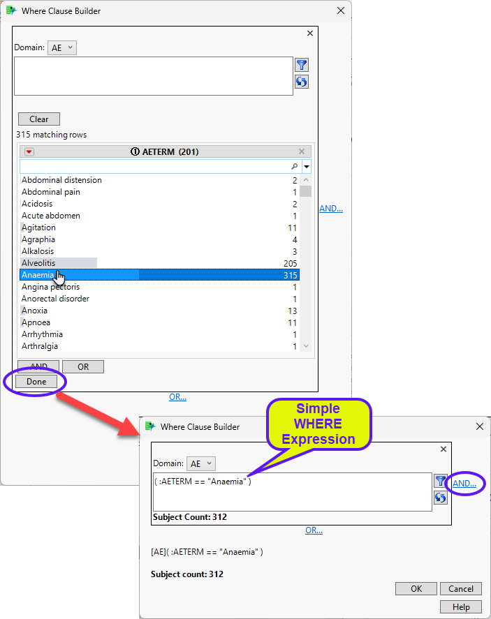

In the following example, we restrict the analysis to subjects who experience severe abdominal distension and anaemia.
To generate the compound WHERE expression, you must first generate a simple WHERE expression.

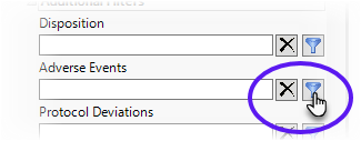

8 | Click from the Adverse Events filter |

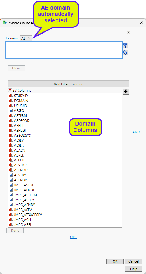

The Where Claussubppe Builder opens.

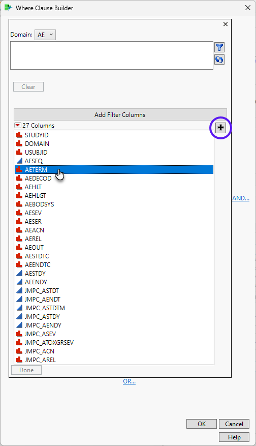

The AE domain is automatically selected as the domain. All of the columns in the domain are listed and are available for selecting.
8 | Click on a column to select that column. In this example, we select AETERM and click . |

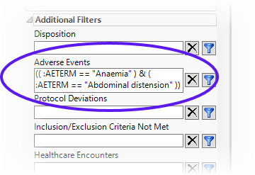

8 | Select Anaemia and click to generate the simple WHERE expression. |

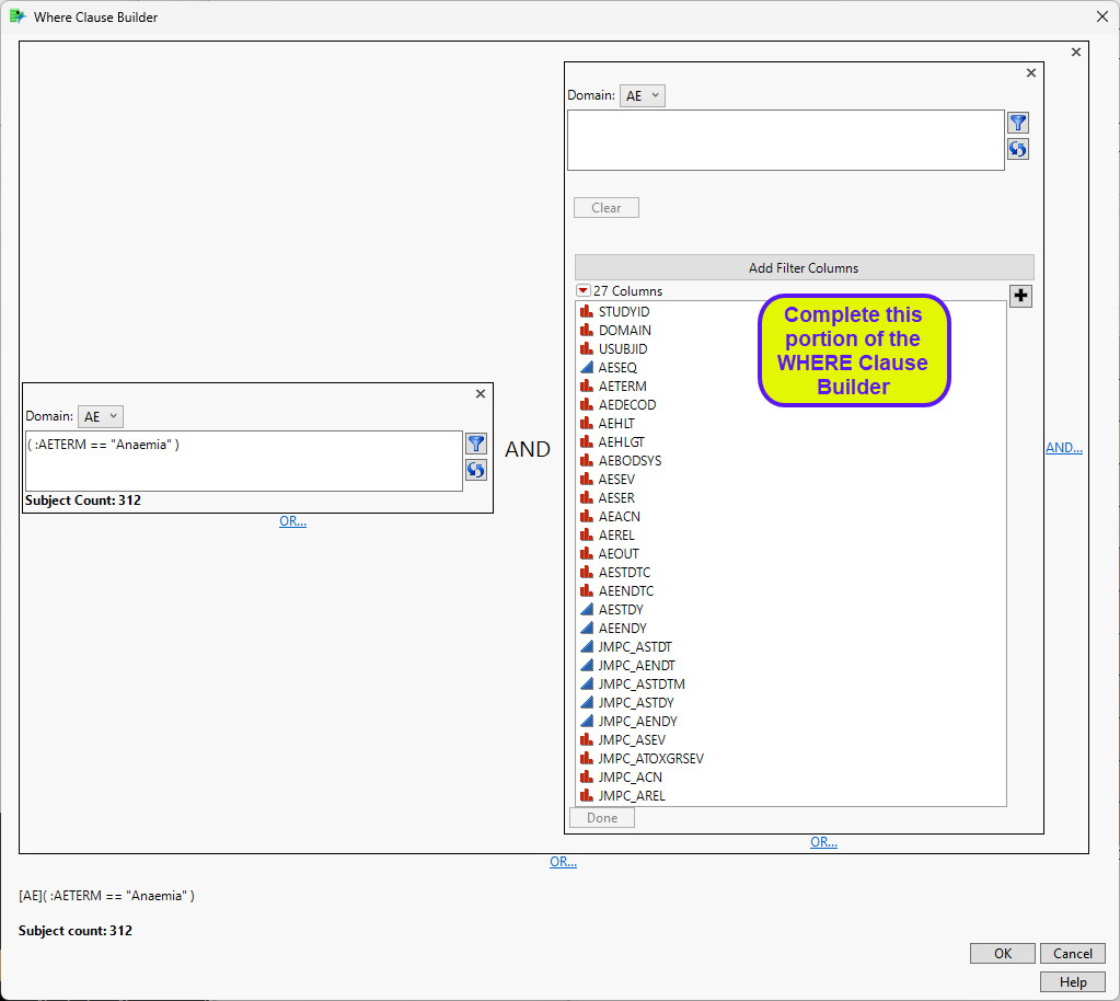

8 | Click (circled above) to generate a complex WHERE expression. |
To complete the second portion of the expression, where AETERM is Abdominal Distension:

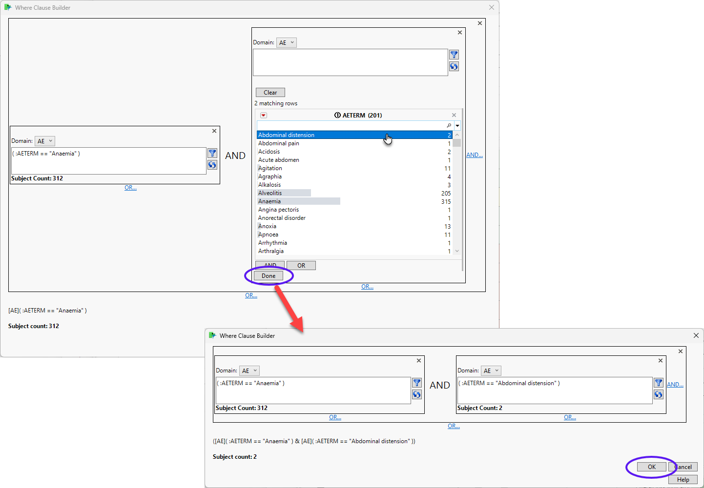

8 | Select AETERM and click . |
8 | Click . to add the WHERE expression is added to the filter in the report. |
Note: You can add additional complexity to the filter anytime during this process by clicking on additional and/or buttons.
