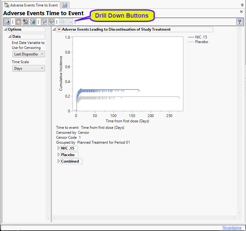

This report presents a plot and several tables.
Cumulative Incidence Plot
This plot shows the cumulative incidence of adverse events over the time elapsed from the first treatment dose. Examination of this plot enables one to see when the events occurred and gives an accurate estimate of the incidence by treatment group. Subjects are censored at the date of the last disposition record unless another date is chosen.

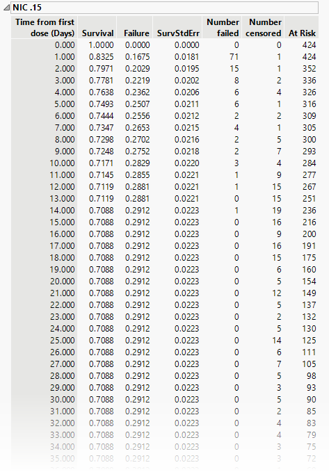

Tables provide basic statistics for each treatment group and for the overall study. The table below shows the results for the Nicardipine treatment group.
The tables list time from the first dose and, at each time point, both survival in the trial and failure to continue, absolute number failed or censored and the number remaining at risk.

End Date Variable to Use for Censoring
Use the End Date Variable to Use for Censoring option for specifying the end date for censoring. Options include the reference end date, date of the last treatment, or the date of the last disposition record (selected by default).
Time Scale
Use this widget to specify the time scale to use for times. Options include Hours, Days, Weeks, Months, and Years. Refer to Time Scale for more information
Action buttons, provide you with an easy way to drill down into your data. The following action buttons are generated by this report:
Click to rerun the report using default settings.
Click to view the associated data tables. Refer to Show Tables/View Data for more information.
Click to generate a standardized pdf- or rtf-formatted report containing the plots and charts of selected sections.
Click to generate a JMP Live report. Refer to Create Live Report for more information.
Click to take notes, and store them in a central location. Refer to Add Notes for more information.
Click to read user-generated notes. Refer to View Notes for more information.
Click to open and view the Review Subject Filter.
Click to specify Derived Population Flags that enable you to divide the subject population into two distinct groups based on whether they meet very specific criteria.
