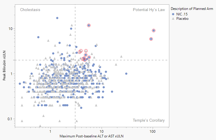

Label Hy’s Law quadrants
Check this option to annotate the plot of Bilirubin against Alanine Aminotransferase with terms relating to Hy’s Law.
Note: This option is unchecked by default.
When you check this option, the resulting plot is labeled as follows:
Quadrant |
Additional location information |
Label |
upper right |
above both reference thresholds |
Hy's Law |
upper left |
surpassing the Bilirubin reference line, but not meeting the Alanine Aminotransferase threshold |
Cholestasis |
lower right |
surpassing the Alanine Aminotransferase reference line, but not meeting the Bilirubin reference line |
Temple's Corollary |
lower left |
not meeting either the bilirubin or the Alanine Aminotransferase reference lines |
none |
Example Output Using This Option
A portion of a Scatterplot Matrix annotated using this option is shown below.
