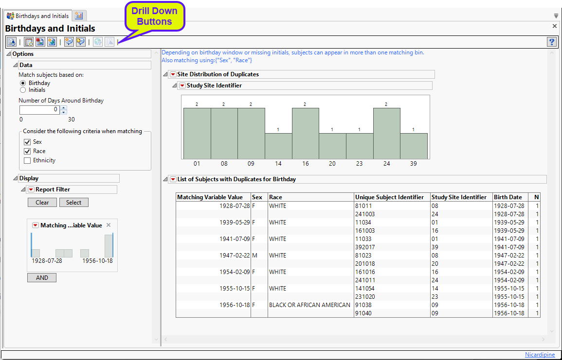

Running this report with the Nicardipine sample setting and default options generates the output shown below.
This section contains the following:
One Distribution.
This Distribution shows the numbers of pairs of subjects sharing the same birth date/initials by the sites at which they occur.
One Table.
This table lists any birth dates where two or more subjects match. Supporting information (if available) to determine whether multiple Unique Subject Identifiers refers to the same person include Study Site Identifier, Date of Birth, Sex, Race, Ethnicity, Height, Weight, and Initials.
See Tabulate for more information.
If the report is run matching on initials, the Matching Variable Value reflects Initials. Here, the section is named List of Subjects with Duplicates for Initials.
Note: Matching by initials will only happen if the Subject Characteristics (SC/ADSC) domain contains the initials of the subjects. Values in the SCTESTCD/PARAMCD column must be either “SUBJINIT” or “INITIALS”.
