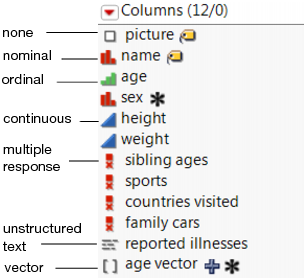

Modeling Type Icons in the Columns Panel
illustrates the icons that identify the different modeling types.
Click on an icon to change the modeling type to
Continuous
Nominal
Ordinal
, or
None

Tip:
You can select Continuous only if your data type is numeric. If the Continuous option is dimmed on the menu and you want to make the column continuous, you must first change the column’s data type in the Column Info window.
