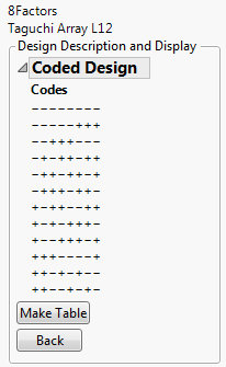

After you select a design type, the Coded Design (
Coding for Eight Factor L12 Design
) is shown below the Factors panel.
The Coded Design shows the pattern of high and low values for the factors in each run.
