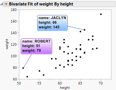

When you place your cursor over data on a graph, a tooltip that contains data values appears. You can pin the tooltip so it always appears on the graph as a label. When you save the graph, the label is saved. When you print the graph, the label prints.
Note:
The tooltip remains pinned after you redo an analysis. However, if the data changed, you might have to reposition the label.
Pinned Tooltips
To pin a tooltip, place your cursor over the data point until the tooltip appears. Click the pin icon in the upper right corner of the tooltip. You can then drag the label to reposition it.
