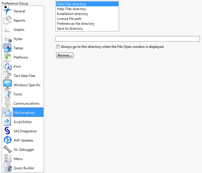

(Windows only) File Locations preferences set the default locations of JMP system files. Usually, the files can stay where JMP installs them, and you do not have to change anything here. However, if you do move files, such as Help files, elsewhere, you should update the location here.
File Locations Preferences
Preferences on the File Locations Page
Preference
Description
Data Files directory
Change the folder in which JMP looks for data files (for example, data tables).
Help Files directory
Change the folder in which JMP looks for Help files.
Installation directory
Change the JMP installation folder.
License file path
Change the folder in which JMP looks for your JMP License file.
Preferences file directory
Change the folder in which JMP looks for preference information.
Save As directory
Change the folder in which JMP saves data files when you select File > Save As.
Always go to this directory when the File Open window is displayed
Select to have JMP always use the selected path when you select File > Open.
