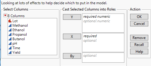

. The launch window in
Fit Definitive Screening Launch Window
uses Extraction3 Data.jmp.
Note:
If you created your design in JMP, the design table contains a script called Fit Definitive Screening. Run this script to run the analysis directly.
Y
One or more numeric response variables.
X
Continuous or two-level categorical factors. Because the platform uses the unique features of a DSD in performing the analysis, these factors must define a DSD or a fold-over design.
By
A column whose levels define separate analyses. For each level of the specified column, the corresponding rows are analyzed. The results appear in separate reports. If more than one By variable is assigned, a separate analysis is produced for each possible combination of the levels of the By variables.
