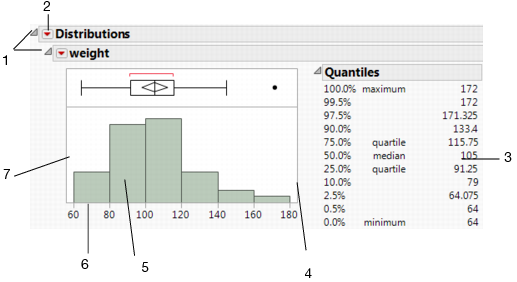

JMP reports are displayed in standard windows with scroll bars and options to resize. They also have other special buttons and menus like those illustrated in
Basics of the Report Window
and those discussed in the following sections.
Report Window Actions
Number
Action
1
Click on the disclosure buttons to hide or show sections of the report.
2
Click on the red triangle menus to access report options.
3
Right-click in the table to access formatting options.
4
Click and drag on the borders to resize graphs.
5
Right-click anywhere in the graph to access formatting options.
6
Right-click within the axis to access formatting options.
7
The arrow cursor turns into a hand when you hold your mouse pointer over an axis. Click and drag using to scroll along the axis or to rescale the axis. See
Scroll and Scale Axes
