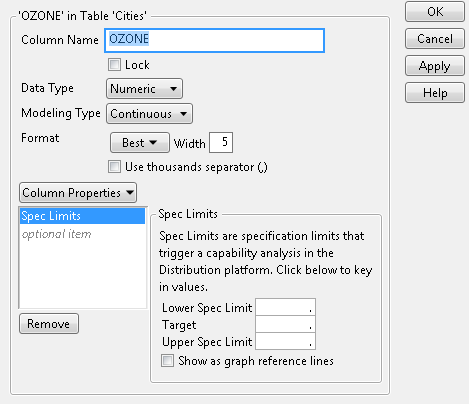

When you perform a capability analysis, you can use Column Properties > Spec Limits to save specification limits as a column property. The Spec Limits property applies only to numeric columns.
Some processes have one-sided specifications. Some have no target. You can enter any of these that apply: a lower specification limit, an upper specification limit, or a target value.
Spec Limits Section of the Column Properties Window
displays the Spec Limits section of the Column Properties window for
OZONE
in the sample data table
Cities.jmp
