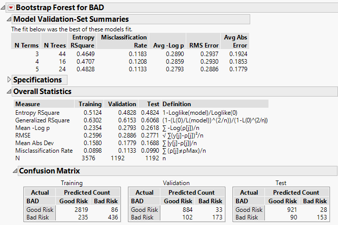

Bootstrap Forest Report for a Categorical Response

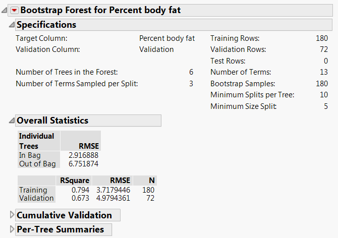

Bootstrap Forest Report for a Continuous Response
The following reports are provided, depending on whether the response is categorical or continuous:
Model Validation-Set Summaries
Specifications
Overall Statistics
Cumulative Validation
Per-Tree Summaries
