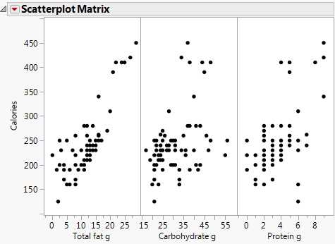

Select Graph > Scatterplot Matrix.
3.
Select Calories and click Y, Columns.
4.
Select Total fat g, Carbohydrate g, and Protein g, and click X.
5.
Scatterplot Matrix Results

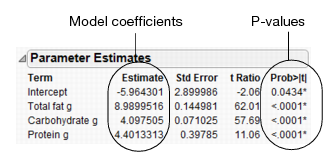

Parameter Estimates Report

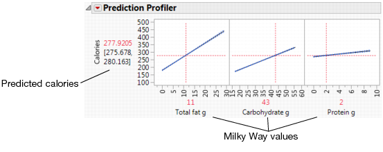

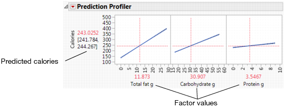

Prediction Profiler
Factor Values for the Milky Way
