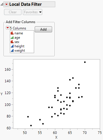

dfObj = biv << Local Data Filter(
	Location( {566, 47} ),
	Mode( Select( 0 ), Include( 1 ) )
dfObj << Add Filter(
	Columns( :Region, :POP ),
	Where( :Region == {"C", "N"} )
dt = Open( "$SAMPLE_DATA/Cities.jmp" );
dist = Distribution(
	Automatic Recalc( 1 ),
	Continuous Distribution( Column( :POP ) )
filter = dist << Local Data Filter(Add Filter( columns( :Region ) ));
f = Function( {a}, Print( a ) );
rs = filter << Make Filter Change Handler( f );

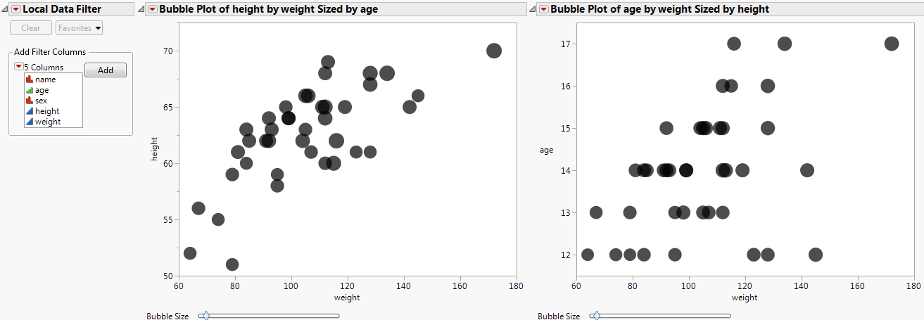

New Window( "Shared Local Filter",
	Data Filter Context Box(
		H List Box(
			dt << Data Filter( Local ),
			Platform(
				dt,
				Bubble Plot( X( :weight ), Y( :height ), Sizes( :age ) )
			Platform(
				dt,
				Bubble Plot( X( :weight ), Y( :age ), Sizes( :height ) )
Tip: To experiment with this script, open the Local Data Filter Shared.jsl sample script.
Figure 8.5 Local Filter with Two Bubble Plots

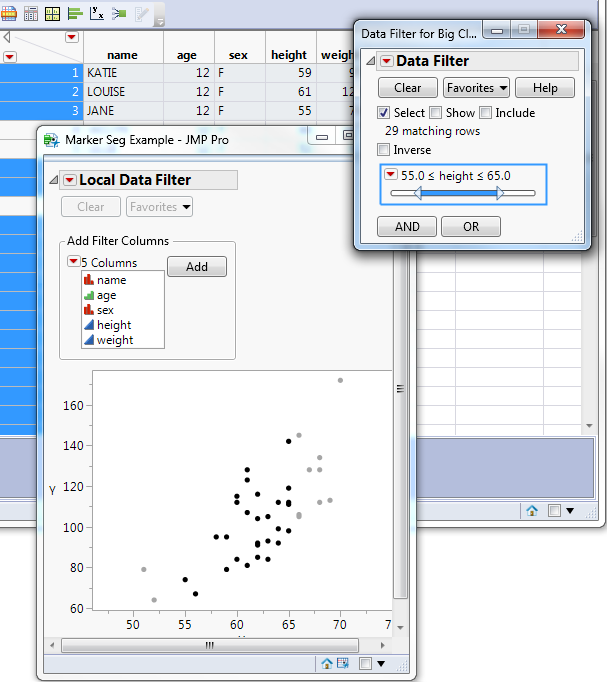

Tip: The following script is part of a larger script that first builds the arrays required for a marker seg. See the Local Data Filter for Custom Graph.jsl sample script for code that builds those arrays.
New Window( "Marker Seg Example",
		V List Box(
			g = Graph Box(
				Frame Size( 300, 240 ),
				X Scale( Min( xx ) - 5, Max( xx ) + 5 ),
				Y Scale( Min( yy ) - 5, Max( yy ) + 5 ),
				Marker Seg( xx, yy, Row States( dt, rows ) )
