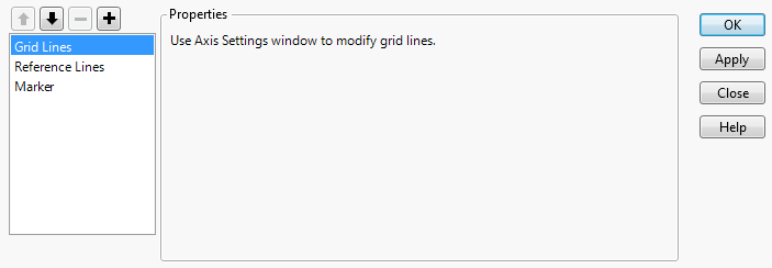

Figure 11.1 Customizing the Graph Options
5.

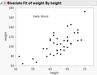

Click the Add button to add a new graphics script.
Text( {55, 160}, "Hello World" );
Now the graph has a text element at the graph’s x-coordinate 55 and y-coordinate 160.
Figure 11.2 Adding a Script to a Graph Interactively
Fill Color( "Green" ); Rect( 57, 175, 65, 110, 1 );
