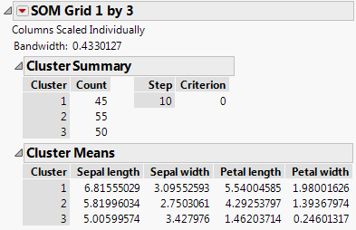

Set N Rows equal to 1 and N Columns equal to 3.

Figure 11.10 SOM Cluster Comparison
Figure 11.11 Self-Organizing Map Report for Iris.jmp

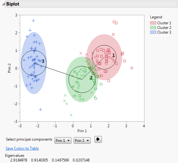

In the data table, select the Species column and select Rows > Color or Mark by Column.
16.
Select the Classic option under Markers.
17.
Figure 11.12 SOM Biplot
