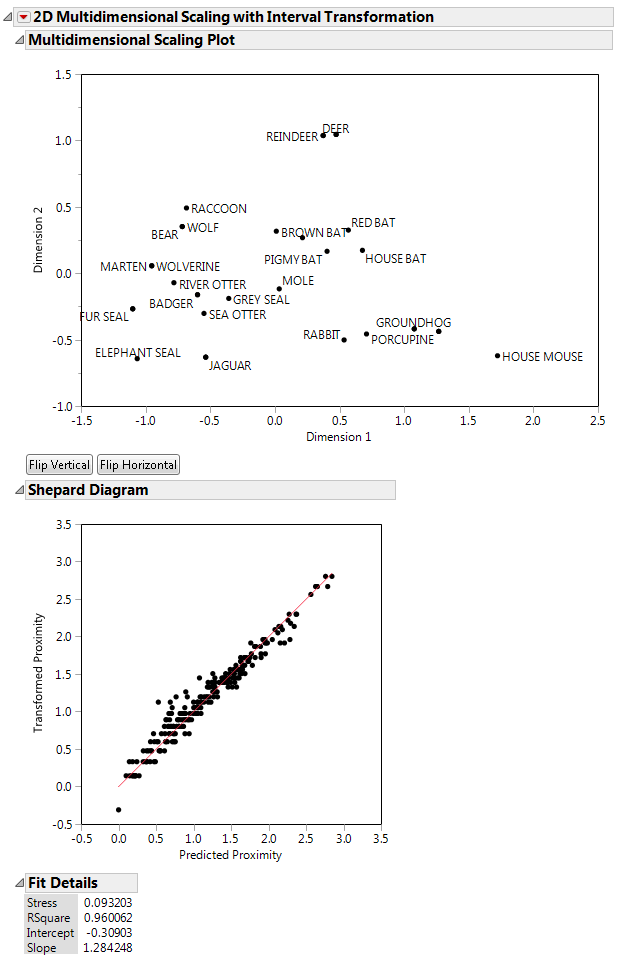

Figure 8.6 Multidimensional Scaling Report
The Shepard Diagram and the Fit Details indicate that the MDS Plot is a good representation of similarities of animals due to similarities in their teeth. The Stress statistics of 0.093 is low and the R2 fit of the transformed versus predicted proximities is high at 0.96. In addition, the Fit Details provides the intercept and slope for the transformation of the actual proximities.
