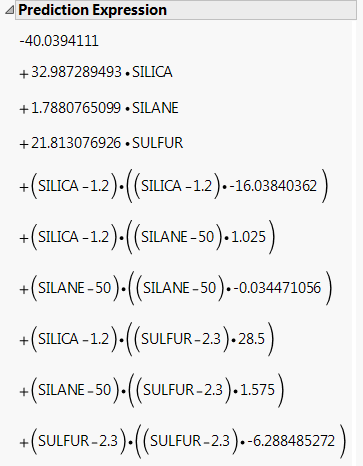

Select Estimates > Show Prediction Expression from the Response ABRASION red triangle menu.
Figure A.17 Prediction Expression for Model with Uncoded Factors
The coefficients do not help you compare effect sizes. The sizes of the coefficients do not reflect the impact of the effects on ABRASION over the range of their settings. Also, the coefficients are not easily interpreted. For example, the coefficients do not facilitate your understanding of the predicted response when SILICA is at the midpoint of its range.

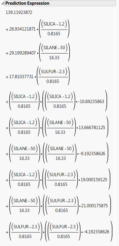

12.
Figure A.18 Prediction Expression for Model with Coded Factors
The coefficients for the coded factors enable you to compare effect sizes. SILANE has the largest effect on ABRASION over the range of design settings. The effects of SILICA and the SILANE*SULFUR interaction are large as well.
