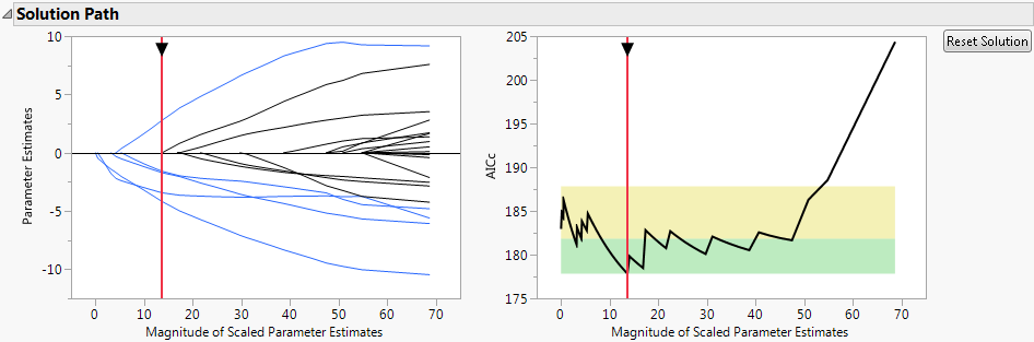

Select Elastic Net as the Estimation Method.
8.
Figure 6.3 Solution Path Plot

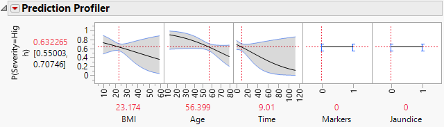

Figure 6.4 Profiler for Probability That Severity = High, Time Low
Examine the Prediction Profiler to see how Time and the Time*Markers interaction affect Severity.
Note: The predictor Hepatitis is not shown in the profiler because it does not appear in any active (nonzero) terms. Because Markers and Jaundice appear in active interaction terms, they appear in the profiler even though, as main effects, they are not active.
11.

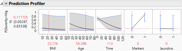

Move the red dashed line for Time from left to right to see its interaction with Markers (Figure 6.4 and Figure 6.5). For patients who enter the study with small values of Time since diagnosis, Markers have little impact on Severity. But for patients who enter the study having been diagnosed for a longer time, Markers are important. For those patients, normal markers suggest a lower probability of high Severity.
Figure 6.5 Profiler for Probability That Severity = High, Time High
