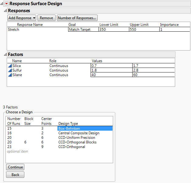

Figure 10.4 Responses and Factors Outlines for Tire Tread Design
Note: Setting the Random Seed in step 6 reproduces the exact results shown in this example. In constructing a design on your own, this step is not necessary.
7.
Click Continue to retain the Box-Behnken design selection.
8.
Click Make Table.

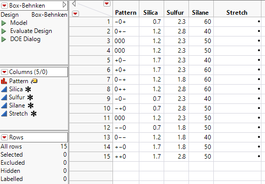

Figure 10.5 Box-Behnken Design Table
