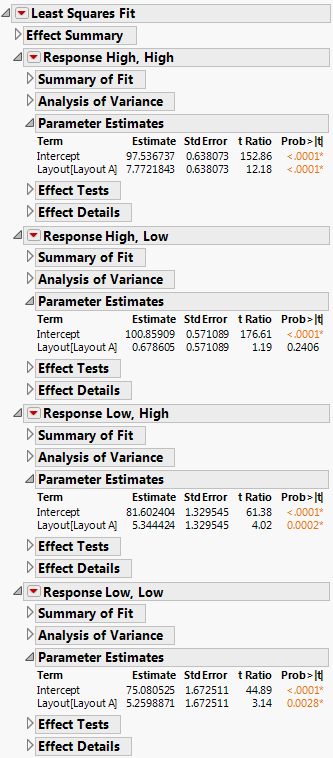

Select Analyze > Fit Model.
Since there is a Model script in the data table, the Model Specification window is already filled in. Note that the columns High, High through Low, Low are entered as Y and that Layout is the single model effect.
4.
Click Run.
Figure 7.38 Four Univariate Models
The report indicates that Layout has a statistically significant effect for all quadrants except the High, Low quadrant.

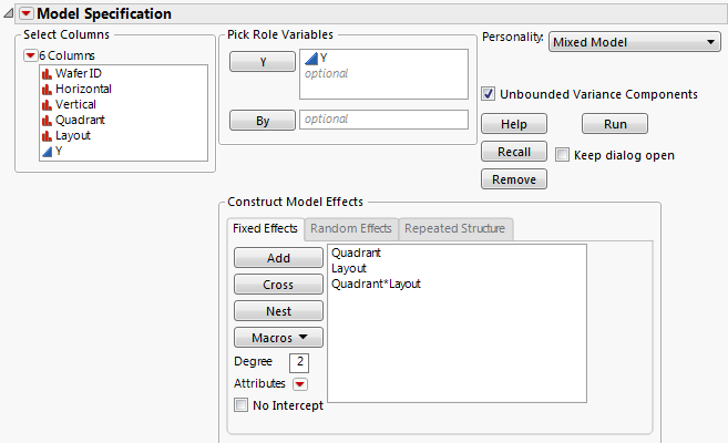

2.
3.
Select Y and click Y.
4.
Select Mixed Model from the Personality list.
5.
Select Quadrant and Layout from the Select Columns list and click Macros > Full Factorial.
This model specification enables you to explore the effect of Layout on the repeated measurements as well as the possible interaction of Layout with Quadrant.
Figure 7.39 Fit Model Launch Window Showing Completed Fixed Effects Tab

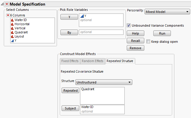

6.
Select the Repeated Structure tab.
7.
Select Unstructured from the Structure list.
8.
Select Quadrant and click Repeated.
9.
Select Wafer ID and click Subject.
Figure 7.40 Fit Model Launch Window Showing Repeated Structure Tab

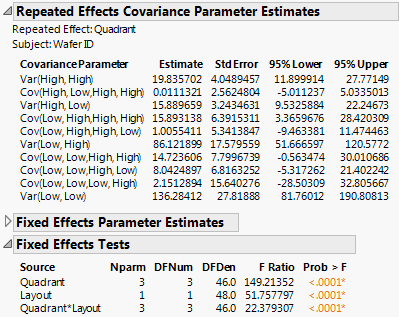

10.
Click Run.
Figure 7.41 Fit Mixed Report with Fixed Effects Parameter Estimates Report Closed
The Repeated Effects Covariance Parameter Estimates report gives the estimated variances and covariances for the four responses. Note that the confidence interval for the covariance of Low, High with High, High does not include zero. This suggests that there is a positive covariance between measurements in these two quadrants. This is information that the Mixed Model analysis uses and that is not available when the responses are modeled independently.
