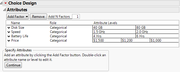

1.
Select DOE > Consumer Studies > Choice Design.
2.
Select Help > Sample Data Library and open Design Experiment/Laptop Factors.jmp.
Figure 17.4 Choice Design Window with Attributes Defined
1.
Click Continue.
2.

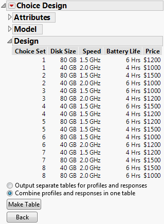

Click Make Design.
Figure 17.5 Pilot Design
3.
Verify that the Combine profiles and responses in one table option is selected.
4.
Click Make Table.
