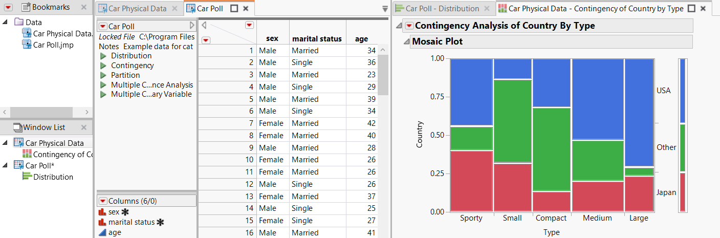

Figure 5.127 Initial Project

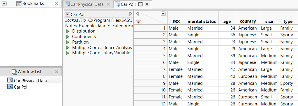

Create a group for the data tables by selecting New Group from the Bookmarks red triangle menu. The group organizes the files but does not move them on your computer.
Figure 5.128 Bookmarked Files

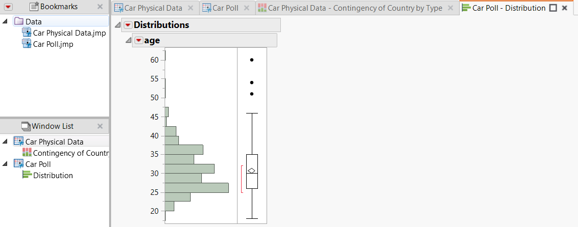

1.
In Car Physical Data.jmp, run the Contingency script.
2.
In Car Poll.jmp, run the Distribution script.
Figure 5.129 Tabbed Reports

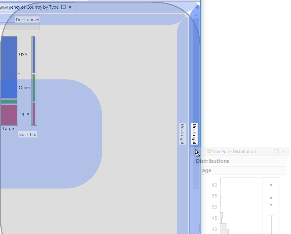

3.
Drag the Distribution report tab to the right until the Dock right zone appears on the far right.
Figure 5.130 Dragging a Report

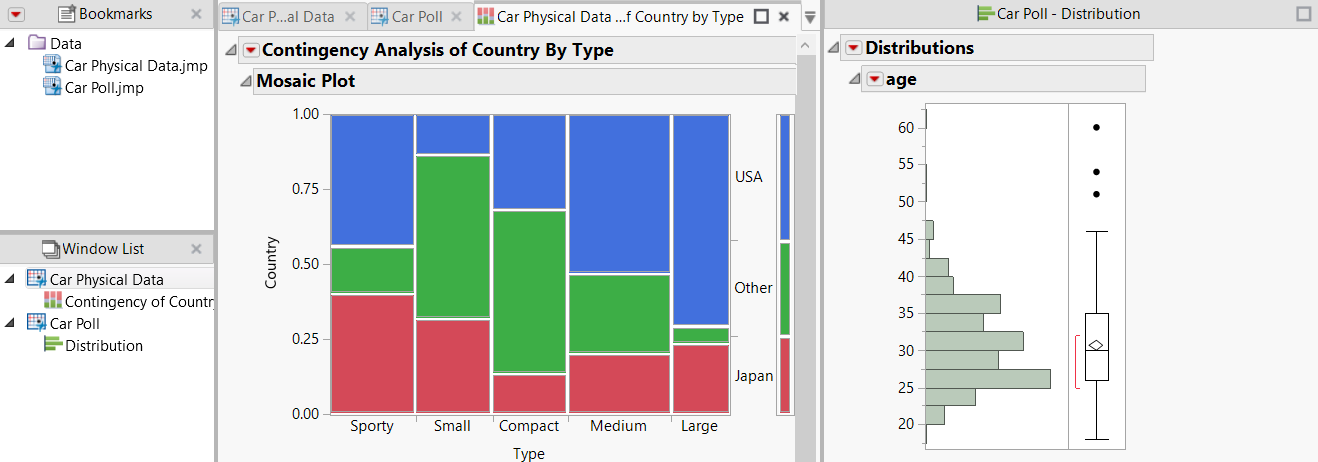

4.
Drop the report into the Dock right zone.
Figure 5.131 Report in New Pane
