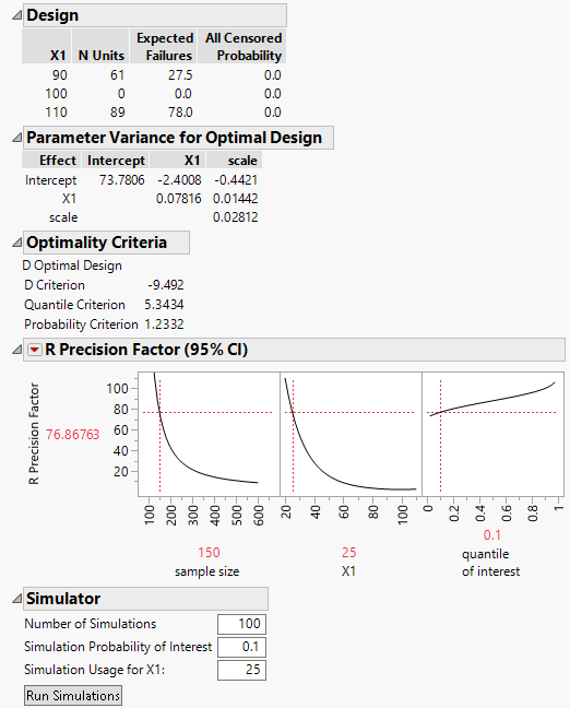

Click Make Design to create the optimal design and see results that address the quality of the design. By default, the optimal design is D-optimal. You can change the optimality criterion by selecting the red triangle option ALT Optimality Criterion.
When you click Make Design, the following report appears:
Figure 21.19 Design Outlines
