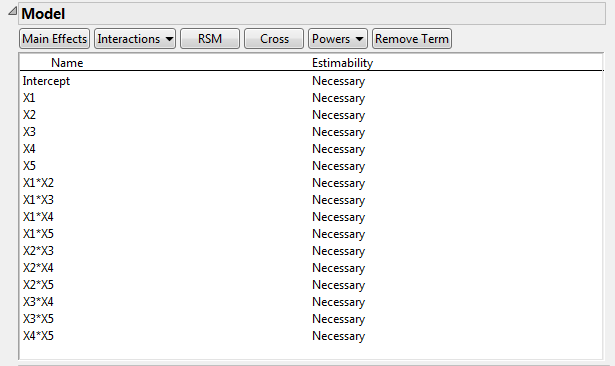

Figure 4.6 Model Outline Showing Interactions

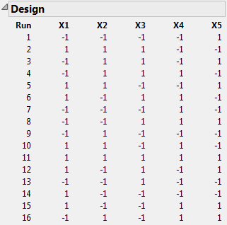

Figure 4.7 shows the runs of the design. All main effects and two-factor interactions are estimable because their Estimability was designated as Necessary (by default) in the Model outline.
Figure 4.7 Design to Estimate All Two-Factor Interactions

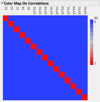

Open the Design Evaluation > Color Map on Correlations outline.
Figure 4.8 Color Map on Correlations
