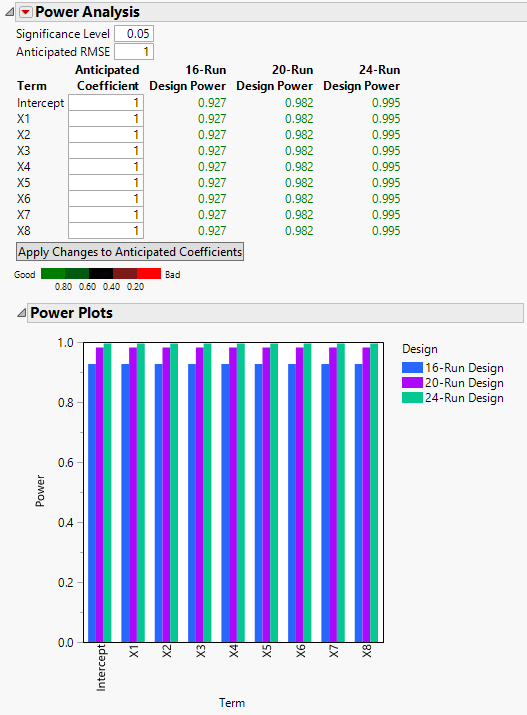

Figure 15.8 Power Analysis Comparison

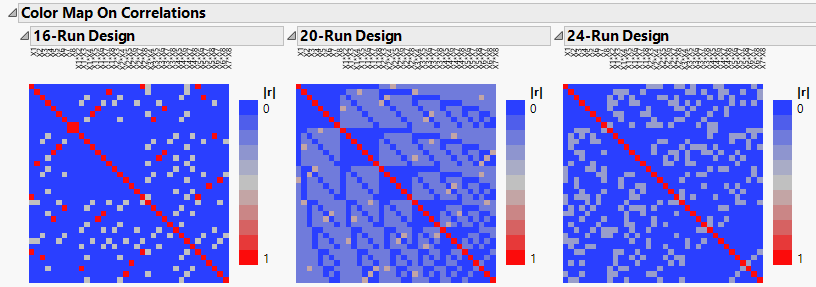

Figure 15.10 Color Map on Correlations Comparison

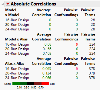

Figure 15.11 Absolute Correlations Comparison

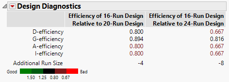

Figure 15.12 Design Diagnostics Comparison
