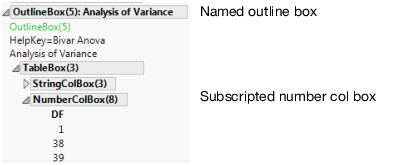

rp = dt << Bivariate(
	Y( :weight ),
	X( :height ),
	Fit Line( {Line Color( {213, 72, 87} )} )
Print(
	"C.Total DF=",
	Report( rp )[Outline Box( "Analysis of Variance" )][
	// string references the parent box
	Number Col Box( 1 )][3] // subscript references the child box
Figure 10.7 Subscripted Display Box
