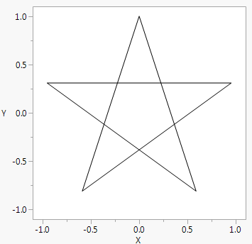

Line() draws lines between points.
win = New Window( "Five-Point Star",
	Graph Box(
		Frame Size( 300, 300 ),
		X Scale( -1.1, 1.1 ),
		Y Scale( -1.1, 1.1 ),
		Line(
			{Cos( 1 * Pi() / 10 ), Sin( 1 * Pi() / 10 )},
			{Cos( 9 * Pi() / 10 ), Sin( 9 * Pi() / 10 )},
			{Cos( 17 * Pi() / 10 ), Sin( 17 * Pi() / 10 )},
			{Cos( 5 * Pi() / 10 ), Sin( 5 * Pi() / 10 )},
			{Cos( 13 * Pi() / 10 ), Sin( 13 * Pi() / 10 )},
Figure 11.10 Using Lines to Draw a Star
You can either specify the points in two-item lists as demonstrated above or as matrices of x and then y coordinates. Matrices are flattened by rows. You can use either row or column vectors, as long as you have the same number of elements in each matrix. The following expressions have the same effect:
Line( {1,2}, {3,0}, {2,4} ); // several {x,y} lists
Line( [1 3 2],[2 0 4] ); // row vectors
Line( [1,3,2], [2,0,4] ); // column vectors
Line( [1 3 2], [2,0,4] ); // one of each
The star example could also be drawn this way. Note that the script must include the full Matrix( {...} ) notation rather than [ ] shorthand because the entries are expressions. The following example uses the Matrix() function.
