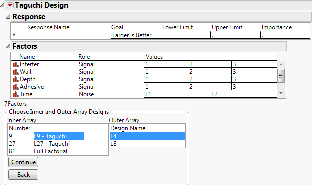

Ensure that L9-Taguchi is selected for the inner array.
5.
Click L8 for the outer array design.
Figure 13.2 Completed Taguchi Design Window
6.
Click Continue.

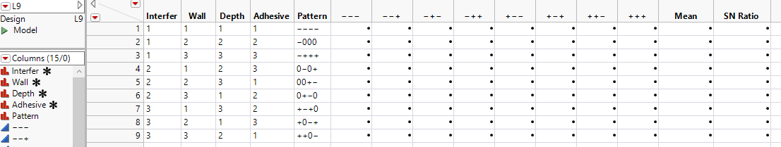

Click Make Table to create the design table shown in Figure 13.3.
Figure 13.3 Taguchi Design before Data Entry

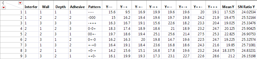

Select Help > Sample Data Library and open Design Experiment/Byrne Taguchi Data.jmp. Figure 13.4 shows the completed design.
Figure 13.4 Complete Taguchi Design Table (Byrne Taguchi Data.jmp)
The SN Ratio Y column is the performance statistic (larger is better) to maximize the response. It is computed as –10 times the common logarithm of the average of the squared reciprocals of the responses:
This expression is large when all of the individual y response values are large. That is, you are trying to find the signal settings that result in the largest response across the noise settings.

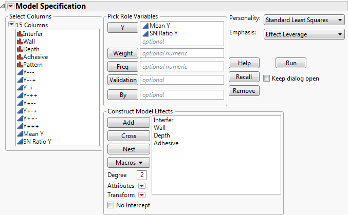

In the Byrne Taguchi Data.jmp data table, click the green arrow to run the Model script.
Figure 13.5 Fit Model Launch Window for Taguchi Data
2.
Click Run.
