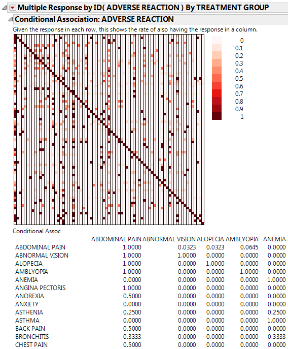

This example uses the AdverseR.jmp sample data table, which contains adverse reactions from a clinical trial. Use this data to explore the conditional association of adverse events and then the relative risk of the events in the treatment group as compared to the control.
1.
Select Help > Sample Data Library and open AdverseR.jmp.
2.
Select Analyze > Consumer Research > Categorical.
3.
Select ADVERSE REACTION and on the Multiple tab click Multiple Response by ID.
4.
Select TREATMENT GROUP and click X, Grouping Category.
5.
Select PATIENT ID and click ID.
6.
Select Unique Occurrences within ID and click OK.
Figure 3.14 Conditional Association Report (Partial Report)

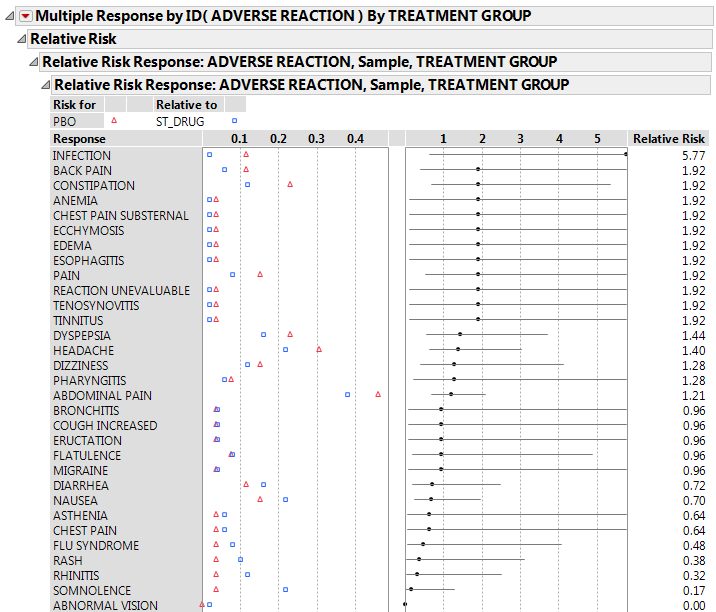

9.
Select PBO in the window and click OK.
11.
Select Relative Risk and click OK.
Figure 3.15 Relative Risk Report (Partial Report)
Right-click and select Columns > Lower 95% and Columns > Upper 95% to add 95% confidence intervals on the relative risk estimates to the report table.
