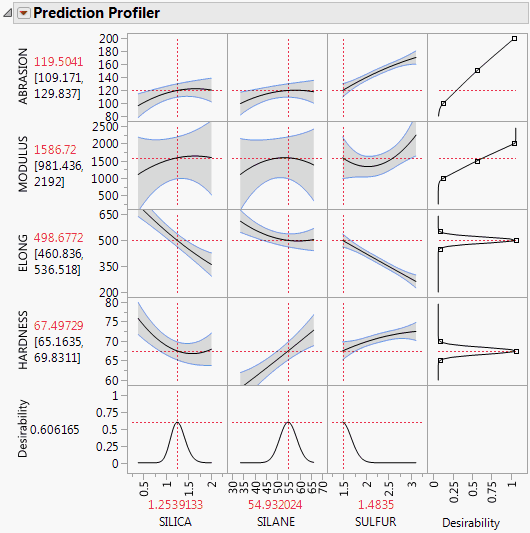

Figure 2.18 Prediction Profiler for Multiple Responses before Optimization
Select Optimization and Desirability > Maximize Desirability from the Prediction Profiler red triangle menu to maximize desirability. The results are shown in Figure 2.19. The desirability traces at the bottom decrease everywhere except the current values of the effects, which indicates that any further adjustment could decrease the overall desirability.
Figure 2.19 Prediction Profiler after Optimization
