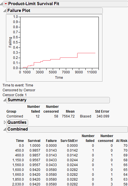

The failure of diesel generator fans was studied by Nelson (1982, p. 133) and Meeker and Escobar (1998, app. C1).
1.
Select Help > Sample Data Library and open Reliability/Fan.jmp.
2.
Select Analyze > Reliability and Survival > Survival.
3.
Select Time and click Y, Time to Event.
4.
Select Censor and click Censor.
5.
Select the check box for Plot Failure instead of Survival.
6.
Figure 12.8 Fan Initial Output

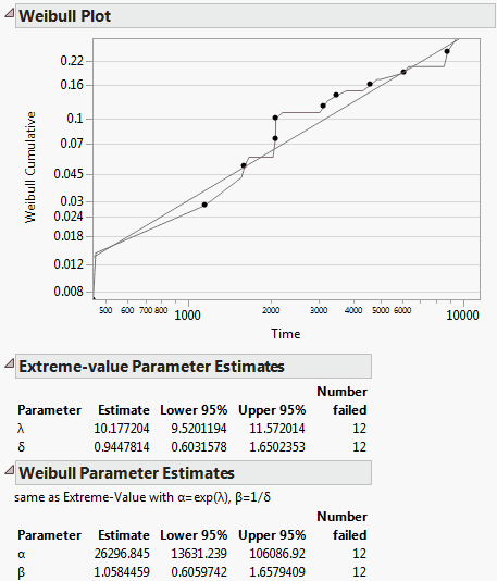

Figure 12.9 Weibull Output for Fan Data

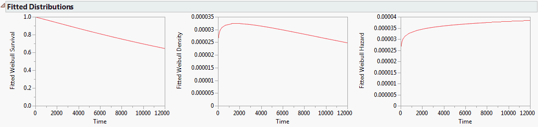

Figure 12.10 Fitted Distribution Plots
