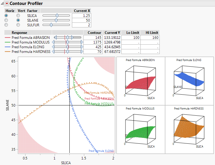

The values for SILICA are on the horizontal axis and the values for SILANE are on the vertical axis. The value for SULFUR is fixed at 2.25. See Figure 3.2.
5.
Click the Current X box for SULFUR and type 2. Click anywhere outside the box to set the value.
6.
In the Lo Limit box for Pred Formula ABRASION, type 100.
7.
In the Hi Limit box for Pred Formula ABRASION, type 160.
Figure 3.3 Contour Profiler for Tiretread.jmp
The contour lines and surface plots differ from those in Figure 3.2 because SULFUR is set at a different value. Move the slider bar for SULFUR to see how different values further change the contour lines and surface plots. The shaded area on the contour plot represents the region of the graph that is not feasible, based on the Lo Limit and Hi Limit values for ABRASION,
