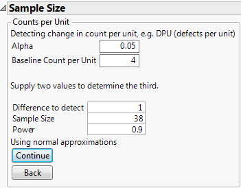

1.
Select DOE > Design Diagnostics > Sample Size and Power.
2.
Click Counts per Unit.
1.
Leave Alpha as 0.05 (the chance of failing the test if the new process is as good as the target).
2.
Enter 4 as the Baseline Counts per Unit, indicating the target of 4 defects per wafer.
3.
Enter 1 as the Difference to detect.
This is the chance of detecting a change larger than 1, which is equivalent to 5 or more defects per wafer. In this type of situation, the significance level (alpha) is sometimes called the producer’s risk and the power (beta) is called the consumer’s risk.
5.
Click Continue.
Figure 16.14 Counts per Unit Calculator
