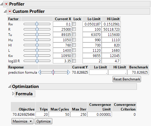

Select Graph > Custom Profiler.
3.
Select prediction formula and click Y, Prediction Formula.
4.
Figure 6.3 Custom Profiler Report

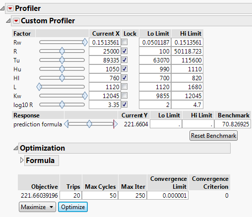

In the Custom Profiler Report, select the Lock check box next to R, Tu, Hu, Hl, and log10 R.
Figure 6.4 Optimized Custom Profiler Report
The optimization routine found an optimum predicted response at 221.66. In order to obtain the optimum of 221.66, Rw and Kw are set to their maximum values and L is set to its minimum value. The optimum is greater than the initial Benchmark value of 70.83.
