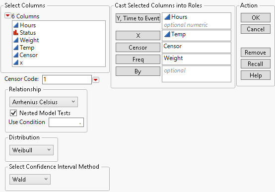

1.
Select Help > Sample Data Library and open Reliability/Devalt.jmp.
2.
Select Analyze > Reliability and Survival > Fit Life by X.
3.
Select Hours and clickY, Time to Event.
4.
Select Temp and click X.
5.
Select Censor and click Censor.
6.
Leave the Censor Code as 1.
7.
Select Weight and click Freq.
8.
Keep Arrhenius Celsius as the relationship, and keep the Nested Model Tests option selected.
9.
Select Weibull as the distribution.
10.
Keep Wald as the confidence interval method.
Figure 3.2 shows the completed launch window.
Figure 3.2 Fit Life by X Launch Window

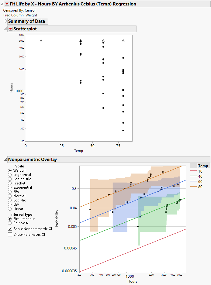

Figure 3.3 shows the top half of the Fit Life by X report window.
Figure 3.3 Fit Life by X Report Window for Devalt.jmp Data
